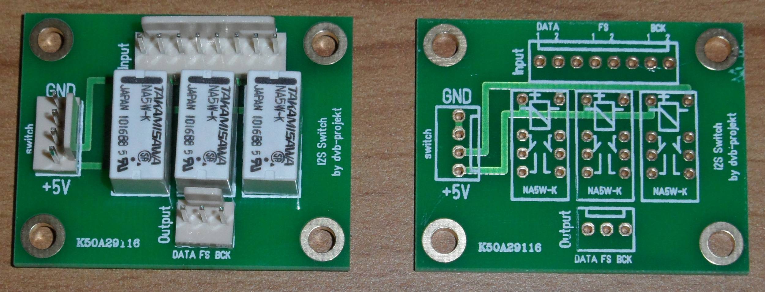

The I2S switch module (e.g. USB & SPDIF)

- separate relays for each I2S signal to get the maximum HF-Isolation
- based on the Takamisawa NA-5WK relay, witch has minimal HF-Insertion loss
- 2mm pcb
- Immersion Gold
- green soldermask on both side
- 35µm copper weight
- Board size 45mm x 35mm
