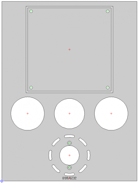

My Reference TDA1541A DAC project comes to the final stage, the housing.
After my decision to make a tube rectifier circuit for the B+ of the Tube-I-zator output stage, i will make a two case design with a separate case for the PSU. Into the PSU case i will insert the two +/- Power Supply Modules and the Tube rectifier circuit. The transformer goes on the top of the case in a separate aluminum housing. Also the tube rectifier goes on top. Because i will use only MKP Mundorf caps in the rectifier circuit, the 47µF and the two 100µF caps goes through the top panel. |
