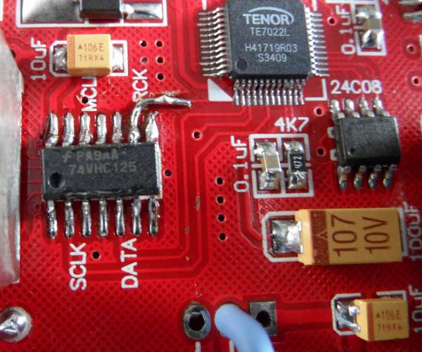

I change the 74HC125 (tPD: 8ns) to the ~53% faster 74VHC125 (tPD: 3.8ns).
This will reduce the added jitter of the Buffer-IC.
At desoldering, i unhitch two solder pads... What a work to fix this problem!
This is no work for rookies
Result: The lower end getīs more punch and the stage open up a bit.
