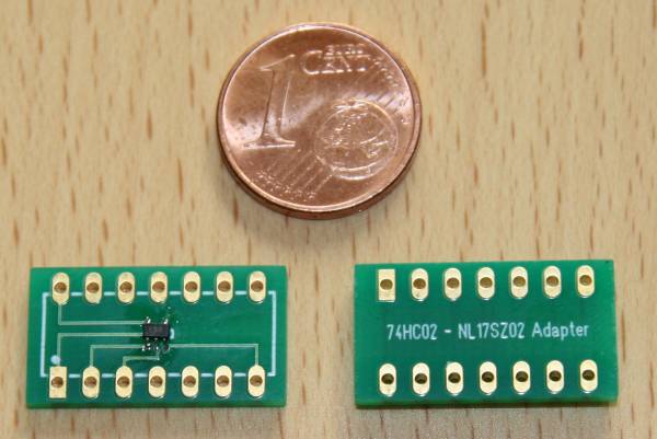

To get minimum additional jitter from the I2S buffer IC, it should be as fast as possible. Therefore i designed an small DIP14 adapter pcb.
With this, it is possible to use the Ultra High Speed Buffer NL17SZ02 instead of the standard 74HC02.
