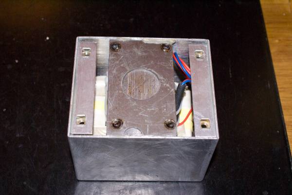

The alum sides and top are also glued on with epoxy, as are the mounting strips with captivated nuts installed. There is a question over the earthing of the alum cover due to the non conductivity of the epoxy but no problem so far. A bit of a hazard though but the HT is only 230 volts.
