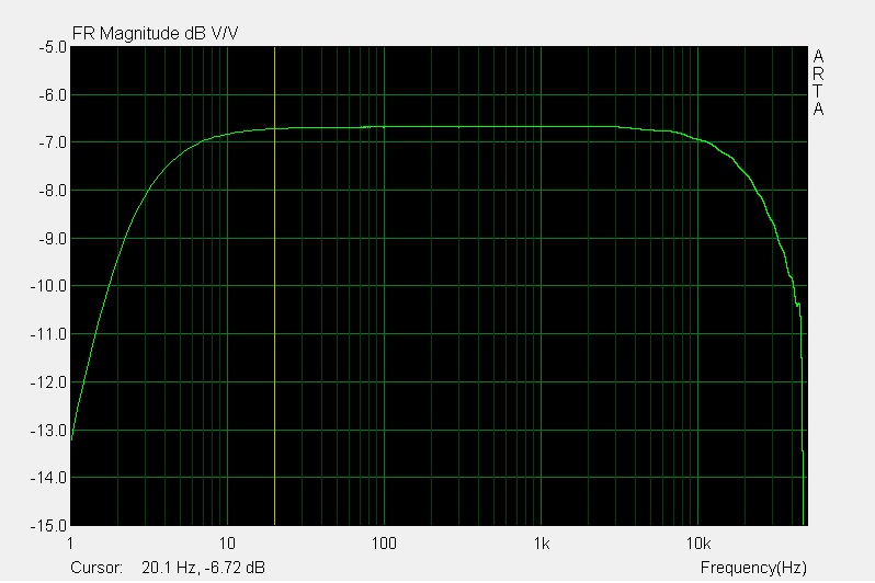

Frequency response of the sound card @ 96khz, please note the scale.
The top end roll off I engineered to be around 1db by the time you get to 20khz.
