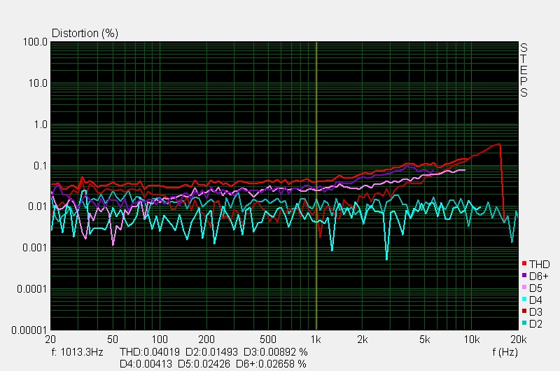

Sixth test, same as the fifth but into an 9.4 ohm load. Once again pushing the output to the maximum I could before clipping was noticeable on the scope. Again this shows the same increase in distortion towards high frequencies. So it's definitely not the output inductors causing this. This represents 65 watts into the test load.
