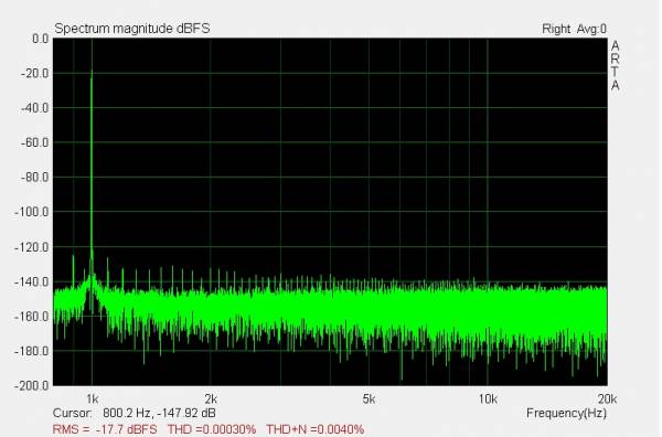

Chips easily meeting spec at 48khz. Note that the noise is most likely inherent to my preamp, which is what was inbetween the DACs and ADC, as the noise for the ADC with no input meets spec.
