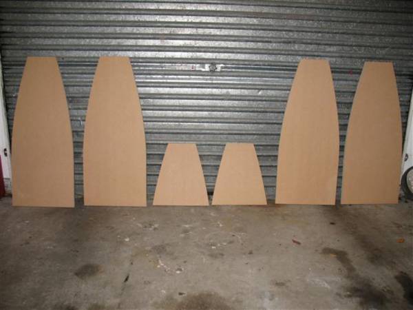

Cutting the curved bits

I made the fronts and backs from 18mm MDF, with the fronts laminated with 9mm ply and the backs with 9mm MDF for a total thickness of 27mm. The internal sealed enclosures for the midrange and tweeter were made from 18mm MDF.
