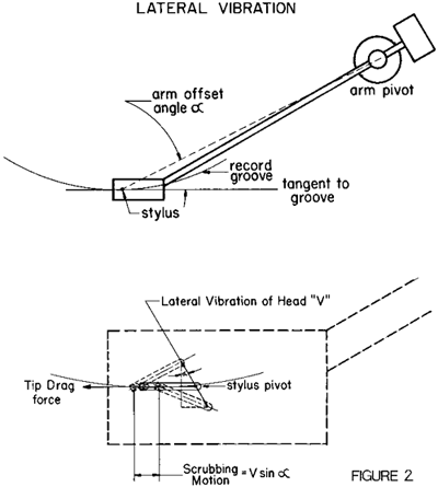

Horizontal resonance motion causes stylus to 'scrub' fore & aft along the groove, and this Frequency Modulate (FM) the audio signal. The amount of horizontal movement that gets translated into scrubbing is related to the offset angle.
