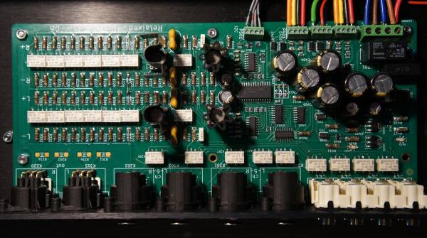

My RelaixedSMD build. Used a 1U 230mm deep hifi2000 case from modushop with an extra steel internal divider and the custom front panel by Jos. The knob is the modushop 29mm machined aluminium one. I used the standard red multi-segment LED display. Went for torroidal PSU transformers. I have fitted a couple of 2.5mm sockets which carry the 5v relay standby signal (5v in standby, off when powered up) - this is used to put my Ncores SMPS in standby (see my Ncore gallery photos).
