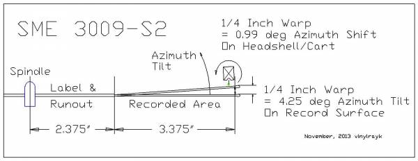

When the pivot axis is not parallel to the line perpendicular to the cartridge, the cartridge azimuth will shift as the arm rides over a warp. But, contrary to common belief, this shift is actually a GOOD thing.
