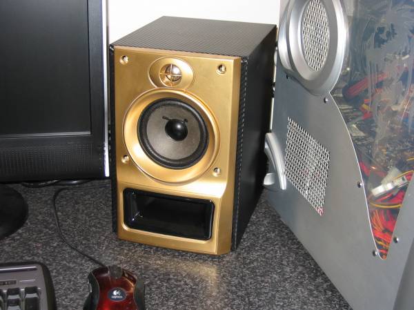

A PC 2.1 stereo for less than £10.
The popular XY 2.1 TDA2030A DIY kit driving heavily tarted up Aiwa 3 way speakers. The two Aiwa bass end speakers are concealed in the cabinets. These are wired in series to two TDA2030A amps in BTL configuration.
