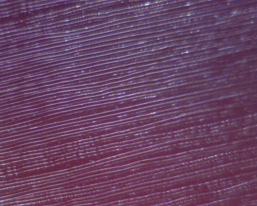

From my reading over the past few weeks it seems that bass of any substantial volume on a record below 120 Hz or so is very intentionally mixed down to mono as this puts the motion of the stylus side to side, a direction of motion that it has much more room to move. You can see the bass as horizontal displacement of the record groove. In my photo below each groove shows up as three lines. A pic from my $70 USB microscope.

I think it's because it's mechanical, i.e. as analog as we are
