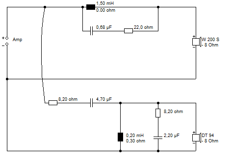

So, I have modified the crossover in one of my B&W DM602S3 speakers. My goal was to tame the "fatiguing" nature of these speakers and I've partially applied The changes discussed here https://www.diyaudio.com/community/threads/b-w-dm602-s3-crossover-mod.328314/post-6826338.
Essentially, I have converted the first order LPF to a second order, putting a 4.7 uF capacitor and 1.5 ohm resister in parallel with the driver ( hopefully that is the right terminology). My understanding is that this second order change would cause the midrange driver to drop off at a steeper rate, hopefully reducing some unwanted higher frequency resonances.

Rutcho's plan was to roll off the bass more steeply to reduce the 4-5kHz typical Kevlar breakup, which you can see on Rutcho's waterfall plot for the bass, and reduce tweeter level by increasing the resistor at the front of the tweeter filter to 3.3R and changing the 4.7uF in the tweeter filter to 3.3uF which raises the crossover point a little.

This is a good way of controlling breakup at 5kHz in this case:
It's called a tank notch, and with 1mH coil you'd want 1uF and 22R for 5kHz. Really changes the sound entirely!
The resistor is important because without it you'd get a dead short at high frequency with a shunt capacitor across the bass.

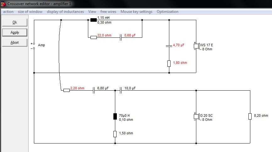

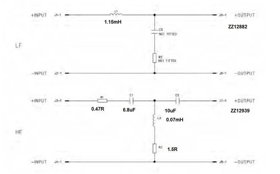

THIS is your B&W 602 S3 Speaker. It's nothing like the 601. I did this schematic work myself years back by wading through the manual.
7" Kevlar bass which I assume is 8 ohms nominal, 4 ohm metal tweeter. Looks like there is room on the PCB for R3 and C3, but I'd try and keep C3 physically small like an NPE type.
B&W Support is down at the moment, so I am a bit limited here:
http://bwgroupsupport.com/
Seems this speaker dips to an alarming 3 ohms at the top end but is described as 8 ohms nominal.

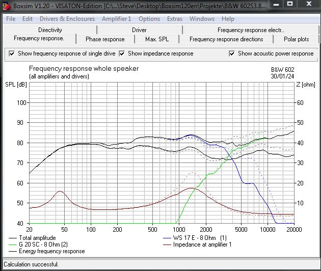

I ran a very rough sim to see how it works. The 8.2R is just a modelling device for an 8 ohm tweeter I used here. The dotted lines are with the B&W original filter.
I found the shunt RC doesn't actually do much. The RC tank cuts breakup around 5kHz considerably. Replacing the 0.47R with 2.2 at the tweeter input improves impedance at the top, whilst reducing level 2dB.
I see I used 1.8R in the shunt, not your 1.5R, but that is no matter.
Make of it what you will. It is what it is. But definitely room for improvement IMO.
