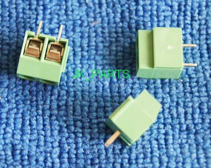

I do have one request though and that's my preference for two position 5mm screw terminal block (1.5mm holes) for audio input.
Have you an exemple or a link?

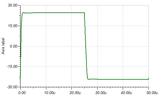

the C||R test is to see overshoot, if any, on fast transients. That gives a clue on stability and margins................@Apex Audio: I will run sim and see how it looks with a capacitive load. Perhaps a 1uH coil and 10R Thiele network on output may be in order to ensure stability?
Do not isolate this from the amplifier.
The R||L between the amp out and the enclosure speaker terminal is to isolate cable capacitance and severe reactance speakers from creating excessive phase loading of the amplifier. This is quite different.

Add 470nF in parallel with 8R load and look 20kHz square waves.
Apexaudio:
Thanks for pointing out potential capacitive loads for an amp to deal with.
Here is the 20kHz square wave with a 470nF load in parallel to 8R resistive load - not pretty with all that ringing:
So I went in and added a snubber and a Thiele network which cleans it up nicely, but the slew rate suffered a bit. For lower distortion speaker sound with typical capacitive (reactive loads), giving up some slew for less ringing is probably a good tradeoff. Here is 20kHz square wave with 470nF and 8R load but with 4.7R+100nF snubber and 2uH+0.47R Thiele in place:
Marc
Like this:
20pcs 5mm Pitch 2 Pin 2 Way Straight Pin PCB Screw Terminal Blocks Connector | eBay

Yes the "snubber" is the same as the amplifier output Zobel.
It is extremely unusual to see any power amplifiers without a Zobel to load the amplifier at high frequency. Some Pass designs and one commercial design (name escapes me).
But you are doing the test incorrectly.
The capacitor is being tested to reveal clues about stability margins.
Do not isolate it from the amp output stage by fitting it after the isolating network of the R||L
At high frequencies the sim is modelling the L as near open circuit and what the sim then models is an R + testC, i.e. a duplication of your snubber. No wonder the overshoot disappears.
Attach the test probe to the amp out, not across the 8r0 dummy load.
So rerun the sim with the 470nF at same location as Zobel snubber?
So where is test probe voltage with reference to if not ground and dummy load? I am confused - maybe a sketch would help. But I honestly thought Apex's point was to show that a bare bones output to a purely resistive load won't look so pretty if the load is a tiny bit capacitive in nature. If it were, and I think passive XO loads are, the R//L will help immensely.
Yes, the C & the snubber and the measurment probe all go the amp out.
You then get to see what the amp tries to do when presented with a fast transient.
But not too fast. Where is your RF attenuation set for frequency? 500kHz, or 1MHz, or 1000MHz?
At the moment that 330pF see no preceding impedance so it cannot operate as an RF filter. The amp sees an ultra fast step response set by your step rise/fall time.
Don't be unrealistic. Set it to somewhere around 10x to 100x the maximum audio frequency of 20kHz i.e. somewhere between 200kHz and 2MHz. See what the amp does with those two filter values after the source step function.
