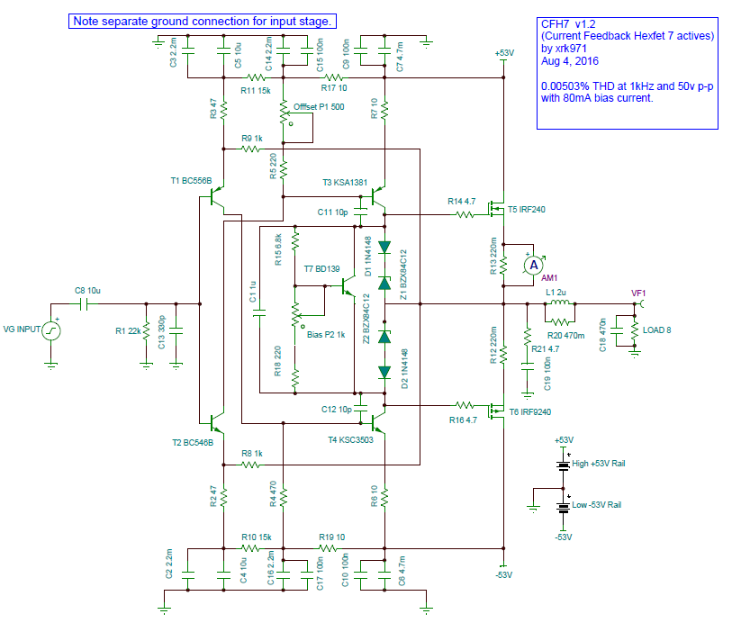

Schematic was simulation condition and although it's possible to run amp at 53v, I was thinking reducing rails allows smaller less expensive 50v caps to be used. Although if you want a 150w amp - leave it at 53v and specify 63v caps on 4700uF and 2200uF VAS caps and 24v on 2200uF input caps. The amp will indeed run at 53v as I have demonstrated it before. Some of the MLCC caps then need to be increased to 63v rating.
The board will be the same for either voltage so doesn't matter unless you will be specifying voltages for caps on silkscreen.

Final v1.1 (I think) schematic. I added some more power rail caps to put a CRC between the main MOSFET output caps and the VAS rail caps. Added trim pot to xero out DC offset. Distortion is still really good (looks like if you run in class A with 1.5a bias, distortion is really low). Square waves resemble what I presented before so I won't show again. This amp is good out to almost 1Mhz.
Add 470nF in parallel with 8R load and look 20kHz square waves.

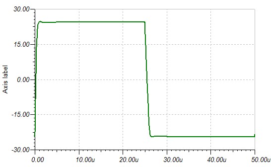

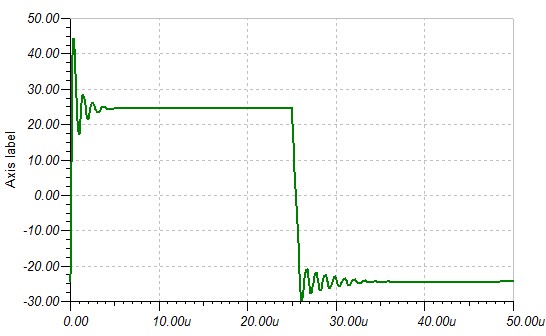

Apexaudio:
Thanks for pointing out potential capacitive loads for an amp to deal with.
Here is the 20kHz square wave with a 470nF load in parallel to 8R resistive load - not pretty with all that ringing:
So I went in and added a snubber and a Thiele network which cleans it up nicely, but the slew rate suffered a bit. For lower distortion speaker sound with typical capacitive (reactive loads), giving up some slew for less ringing is probably a good tradeoff. Here is 20kHz square wave with 470nF and 8R load but with 4.7R+100nF snubber and 2uH+0.47R Thiele in place:
New schematic with above mods, the THD with a 470nF and 8R load with new circuit is now 0.00503%, still a decent figure I think:
4 more parts to the output. I was surprised that a 0.47R in parallel with the 2uH gave the best result (this was tweaked for optimal square wave rise and minimum ring and overshoot). Usual values are circa 10R and 1.2uH.
But, if you plan to use this as an amp to direct drive an active speaker driver with no capacitive load cross-over, use the V1.1 circuit (bypass the snubber and Thiele network) for the highest slew rate with lowest distortion. But if using conventional passive speakers with capacitive elements in crossover, better to use v1.2.
Edit: @AndrewT, is the Zobel the same as my RC snubber?

last first.
Yes the "snubber" is the same as the amplifier output Zobel.
It is extremely unusual to see any power amplifiers without a Zobel to load the amplifier at high frequency. Some Pass designs and one commercial design (name escapes me).
But you are doing the test incorrectly.
The capacitor is being tested to reveal clues about stability margins.
Do not isolate it from the amp output stage by fitting it after the isolating network of the R||L
At high frequencies the sim is modelling the L as near open circuit and what the sim then models is an R + testC, i.e. a duplication of your snubber. No wonder the overshoot disappears.
Attach the test probe to the amp out, not across the 8r0 dummy load.
So rerun the sim with the 470nF at same location as Zobel snubber?
So where is test probe voltage with reference to if not ground and dummy load? I am confused - maybe a sketch would help. But I honestly thought Apex's point was to show that a bare bones output to a purely resistive load won't look so pretty if the load is a tiny bit capacitive in nature. If it were, and I think passive XO loads are, the R//L will help immensely.
Yes, the C & the snubber and the measurment probe all go the amp out.
You then get to see what the amp tries to do when presented with a fast transient.
But not too fast. Where is your RF attenuation set for frequency? 500kHz, or 1MHz, or 1000MHz?
At the moment that 330pF see no preceding impedance so it cannot operate as an RF filter. The amp sees an ultra fast step response set by your step rise/fall time.
Don't be unrealistic. Set it to somewhere around 10x to 100x the maximum audio frequency of 20kHz i.e. somewhere between 200kHz and 2MHz. See what the amp does with those two filter values after the source step function.
