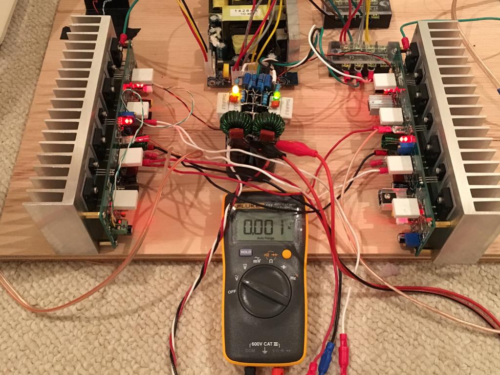

I was surprised to find that running an Abletec 53v SMPS (not made in China) with the CRCLC filter from my linear supply I was able to get 1mV ripple in quiescent mode. This supply has high momentary peak current capability but not sure how or if it can work on HB. It seems to power the VHex+ nicely. I have never had such a quiet speaker when no source playing. SMPS says it can supply 900w for peak load for 10ms.
https://www.parts-express.com/pedoc...9111X1517312X7b875e212d341da299515824c5698b2c
http://www.diyaudio.com/forums/class-d/281698-abletec-53v-dual-rail-450w-supply-20-a-12.html
