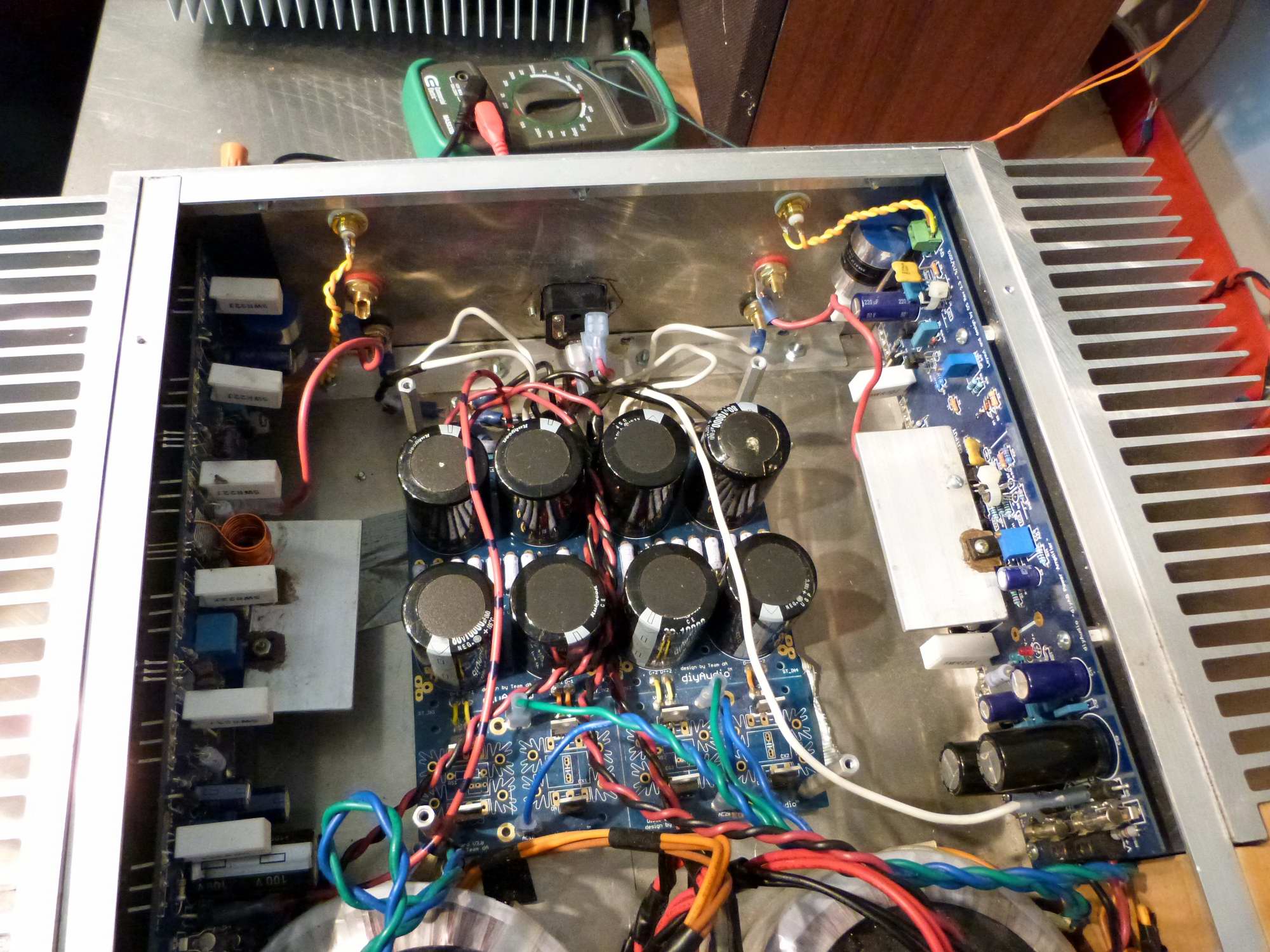

I have finally had time to test a bit more. I have removed the safety earth from the chassis temporarily. The input signal wires going from the RCA connectors at the chassis to the amp pcbs were also removed.
Any ideas on where to look next? Here is a picture as well (I will twist the power supply wires instead of braiding them, as suggested by jwilhelm and AndrewT)
If I leave the star ground floating from the chassis there is a relatively loud noise. This noise sounds like white noise over the entire frequency range. So the noise from the bass, midrange and tweeter is roughly equally loud.
- If the star ground is connected to the chassis most of the noise disappears, leaving just a faint HF (white noise like) sound in the tweeter. It is hard to see this wire on the picture, but it's the black one going from the PSU ground to the lower left corner of the transformer cover.
- In both wiring cases mentioned above there is a clicking sound in the speakers every time you touch the chassis with your hands.

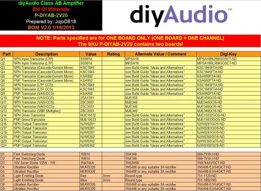

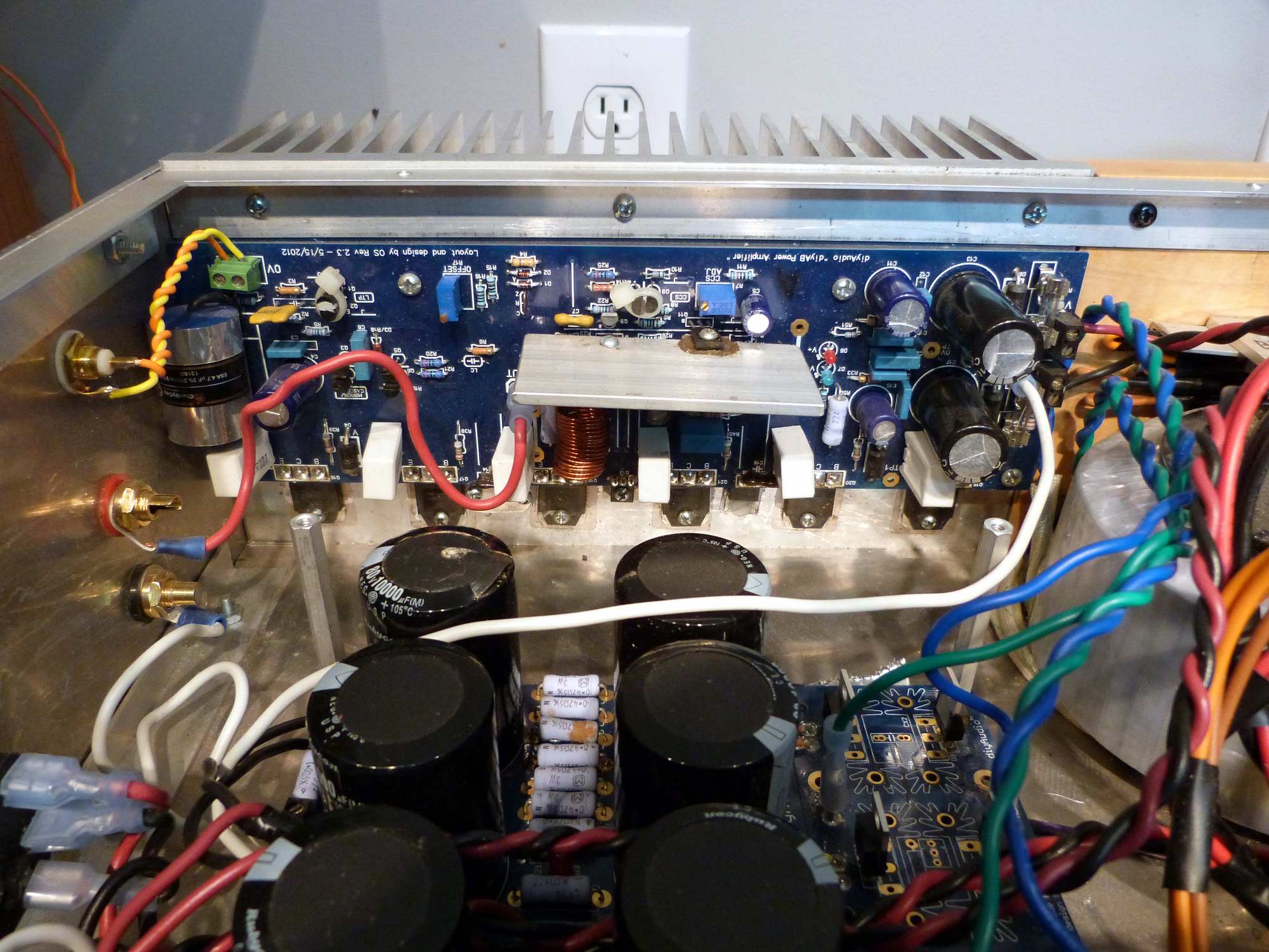

Hi OS/Guys,
I double checked my build, all parts were from Digikey and I used the DIYAudio BOM. Below I've attached a few pics of my build and the BOM. I checked calibration tonite CSS read 8.25vdc across R14, Bias TP1 - TP2 was 44 mV, offet was about 1 mV for each channel. I adjusted to these from the DIY build guide. Zener referenced cascade with TMC for the VAS. The hiss is present with or without source connected, it was even there when I disconnected the inputs to the board. You need to be close to the tweeter to hear it, within 2-3 ft. Maybe some of the devices that I got from Digikey were defective. If you have any ideas let me know, I can replace them.
Appreciate any help.
PJN
Hi OS/Guys,

Typically , with my good ears ... and 91db/w tweeters - I need to put my ear
right on the tweeter to hear the hiss. The room needs to be silent , as well.
This was with my wolverine ( nearly the same as the badger) with higher
global gain 36X.
OS
Have you tried it without the speaker protection? It sounds like something is chassis grounding your audio signal ground.
I have tried with the ground wire from the speaker protection board detached from the star ground, so that the power supply to the protection board is floating, and it made no difference. With the input shorted, I still have the HF noise in the tweeter. My build is according to the BOM with parts from Mouser
Try a typical small 4.7uf /50V wima input cap instead of those "boutique" ones.
OS
