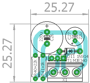

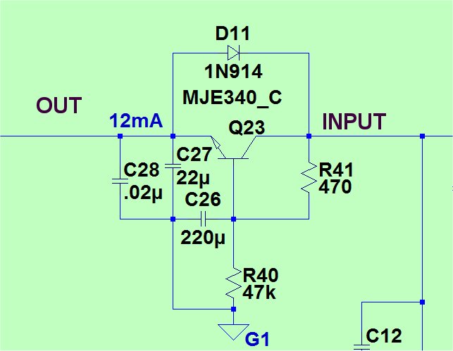

I've decided to try my hand at a capacitance multiplier for the front end of the Badger. I have never tried translating a schematic to a board, and a have only a tenuous grasp of the schematic. So before I blow-up my Badger...
I have attached a schematic of the multiplier OS proposed, and my perf-board layouts (based on the schematic) for positive and negative supplies. Can someone who knows better than I (which is 99.9999% of the people here) confirm whether I completed the board layouts properly?
I plan on connecting the multipliers with wire: Vs to the source, Vo to the output, and the grounds to the star ground on the Badger PCB (I'll probably attach them to the open spot right next to the speaker ground).
All sound good? Am I missing something?
Thanks!
Remove C28 and locate the supply rail decoupling at the main current consumers in the load PCB.
C27 is missing.
The 470r & 47k give a 0.99:1 ratio for the base voltage to the input voltage.
You may want to look at decreasing this ratio a bit to ensure the base is protected from excessive ripple.
Your RC time constant for the 220uF & 47k is over 10seconds, so I think you could reduce it to 22k, or maybe even as low as 10k.

Andrew, thanks for your response!
Would 1K and 22K on the resistors be better?
Regarding the caps:
It is my understanding (see here) that capacitors that serve the purpose of C27 and C28 (decoupling) are already built into the HB layout (C10 & C11), which is why I didn't include them on my board.
Does that work?
Besides the items you pointed out, everything else looks fine?
