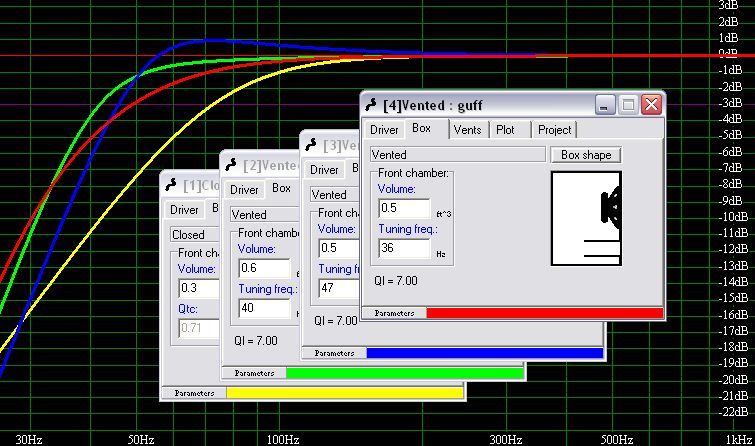

I'll use PE .5 cu 2-way cabinet for vented design with a port tuned at 47Hz.

47Hz is too high a tuning frequency, say 40Hz, I like the look of 36Hz.

If I wanted to use these speakers without a subwoofer, I'd go with 40Hz for deeper bass. But I wanted a bit more upper bass for seamless blend with my sub. But your point is well taken. It seems that 44Hz Fb is a good compromise.47Hz is too high a tuning frequency, say 40Hz, I like the look of 36Hz.

JMO that sealed boxes work far better with subs transient reponse wise.
And remember all things being equal a smaller box sounds better,
due to greater rigidity / lower panel area, and they fit in better.
I'd go for the 0.38 box sealed .........

The reason is probably that in a sealed box bass response decreases at -12dB/oct and with another -12dB/oct filtering of a receiver I can achieve -24dB/oct, which can be matched with the usual -24dB/oct decrease of subwoofer filtering? I think this is a good idea.sreten said:JMO that sealed boxes work far better with subs transient reponse wise.
