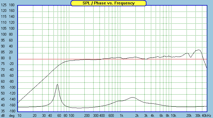

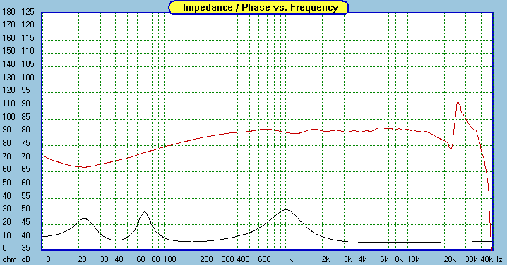

Here's my final decision on the XO. Its network, frequency response, and impedance and phase curves are as below:
The nominal crossover frequency is 1.6kHz. Although there are some cone breakup nodes left, the single series notch works as intended and the breakup garbage should be inaudible. The advantage of this XO design is its simplicity, much simpler than the combination of a parallel notch and an electrical 4th order network or Jon Marsh's Modular MT. The frequency response is very flat and impedance is also benign. I've decided to go with a sealed box using PE .38 cu ft cabinet with its volume reduced to 8.5 to 9 liters by some filling. This will lead to a much more seamless blend with a subwoofer than a vented design with a .5 or .75 cu ft box.

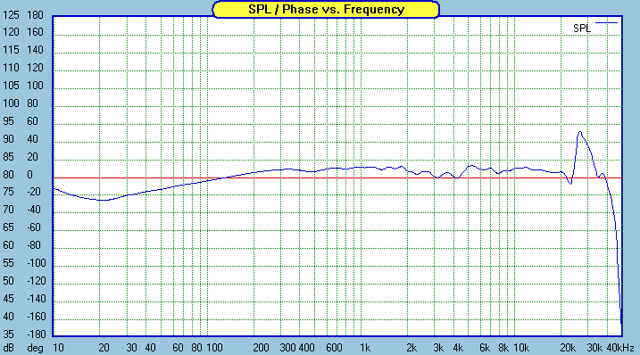

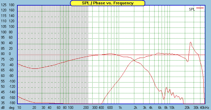

For comparison, below are the Modular MT's XO and its predicted FR in the same sealed cabinet:
Jon Marsh is not a fan of treble (as in the Modular MTM). In the original .75 cu ft vented box with a 17"x10'' baffle (i.e., less baffle step effect), this Modular MT is designed to emphasize midbass and midrange than treble. In a sealed box, as you can see in the above FR chart, the XO will emphasize only (upper) midrange. This might sound good to someone, but not to me! I like neutral sound and love treble.

In that case, mine has about 4dB baffle step compensation, which is what I aimed for.

Have you intentionally reduced the amount of BSC in your final design (or shifted it up in Hz at least) compared to your original design 1 and 2? (ie. now using a 2.5mH inductor on the RS180 when originally it was 3.0mH?
I see a 1-2dB rise from 500Hz to 3KHz. Over such a large bandwidth you might find it a bit forward sounding (or have I missed your BSC somewhere?). Designs 1 and 2 look better than your finalised version.

Yes, I did so intentionally. The previous designs have about 5 to 5.5 dB BSC. My room is treated with absorption panels and plus I really like lively and forward sound rather than laidback---I love my Grado SR225 headphones . I'll place the speakers on 24" stands a bit far from walls. Even so, the room will compensate for some (if not all) of the remaining 2dB baffle step. What do you think?

Of course all the simulations above include -0.8 inch offset specified for the midbass driver, which is about right for the real acoustic offset of a 7" driver on a flat baffle.
Read the Jon Marsh's design page. I suspect that his measurement was obtained before some fine tuning. He was aware of the "BBC" dip when he posted the FR measurement. Perhaps he addressed that sometime later? I'm not sure. Also look at another page for the use of Dayton RS28A-4 tweeter in the design. The dip is not there.
