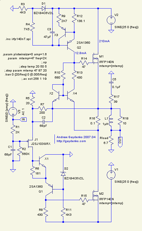

janneman said:
Andrew,
This is pretty intriguing! I guess the Iq is aroundf 50mA? Have you tried to run it with larger current, what would the transfer function look like then?
Do you know the open loop freq and phase response?
Jan Didden
As shown at the schematics, Iq is about 210mA. With too low Iq derivation isn't so smooth around 0V. I think, Iq about 100-150mA will be acceptable. Will see.
dVout/sVin doesn't change with more amplitude of linear input signal: "all can happen already happened" inside +/-11V range :) Only a clipping at ~19V is outside the picture.
As for frequency prediction, I have found simulated results rather differ from reality for gnfb topologies. Moreover, you can see rather "strong" hf correction. At any case I'm not a fanatic of using instrumental amps for listening to a music ;)

Interesting way to drive a quasi fet output stage. Very asymmetrical, even for quasi. There are members here who chastise asymmetrical topologies, but not me. I believe choice of components is more important, depending on goal of the circuit. The input j-fet is cascoded and keeps 5-6 Vds. This is good, and no need for matching because there is only one.:D I do have one question, do you think there would be need to have an active turn off device for M2 instead of R7 even though it appears to never turn completely off, but operates as class AB, or some type of totem pole buffer to drive the gate capacitance? How is capacitive loading for a sqare wave look at that 2KHz? And 10KHz?

I have tried CC-follower between R7 and R18 - at least in simulation all the amp seems to be closer to oscillator :) Moreover, I have two amps with 560 and 680 ohm resistors at similar places with the same mosfets - both works fine.
As for square waves, at first, there isn't any difference which frequency we use to test. A rise or fall time period does mean only. At any case, the amp is sufficiently fast to work with sound - just from experience.

Regulations were mentioned above. For two channels, probably, input fets must not be too different. A fet - current source must be able to generate ~4mA. Currently I don't see something else. Just want to repeat, the project isn't soldered yet - just design. But parts are ordered.

I really like your 49 circuit (cascoded 2sj103 as input-voltage gain stage). Isn't the transconductance of 2SJ103 a bit low? What is the open loop gain of the amp ? I wonder what BJT would be good as a buffer (X5) since M2 has a very big capacitance working in the "common source" mode. Also it seems to me that R16/X2/X4 are controlling the M1 in the similar way as it is done in NP's Aleph CCS (correct me if I'm wrong). Maybe it would be better to take a voltage sample from X5?

Probably another jfet may be used, but I have 2SJ103 :) The fet is loaded with "current source" (Ube/R5), and such load defines stage gain.
Open loop gain depends on instant DC value. I don't remember values as am not interested in it :)
All Xn bjt are 2SA970/2SC2240 wrapped with few elements to simulate thermodynamic ("memory") distortions. It is done like here: http://gaydenko.com/spectrum/case03/schematics.png - left schematics.
As Vce is small for X5, 2SC2240 is suitable here.
I have not digged in Aleph (one of my aims is to get DC amp, which I have achieved ;) ) and didn't understand what do you mean saying about "voltage sample from X5". M2 is N-channel also. Will you explain more detailed?
R16/X2/X4 tries to keep M2 Id at constant level, and R16 is this current sensor.

Thanks, it's more clear now. My remark about similarity with Aleph is only in context of "modulating" a CCS (with some ~ current or voltage) which is a very old technique (White Cathode Follover). Anyway, that's not crucial in your circuit. What appeals to me is nice solution of thermal problems with V-MOSFETS and class AB artefacts. Also, some previous experience (and gut feeling) tells me that this amp (sch.49) should really sound good.
