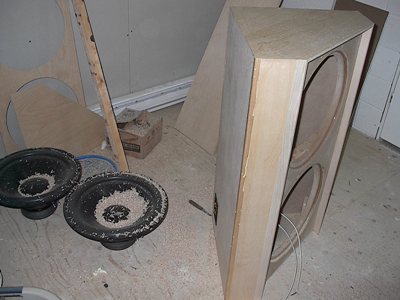

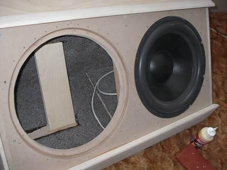

What did you end up stuffing that box with?? Or did it need any?
" ... and were very liberal with internal bracing! ..."
That's the hot tip from GR-Research.com as well = lots of bracing, corners, across the "flat lands" = the broad surface area between the corners. Check out his plans (pdf files on line).
I wish I had some pictures of the insides of some cabinets I saw while working at a pro audio company. They only used baltic birch plywood and were very liberal with internal bracing! I've seen some of the cabs with 2 15s take a 10 foot drop onto a stage and the damage was mainly cosmetic.

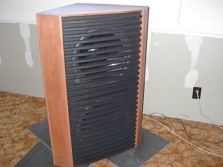

" ... two layers of 3/4"MDF ... plus an outside layer of 1/2" maple veneer ply ..."
!! no wonder it weights 200 plus pounds !! I would bet the amp and speakers are only about 1/4 of the total.
The result is quite handsome ... keep up the good work. Canadian wood, naturally 😉
