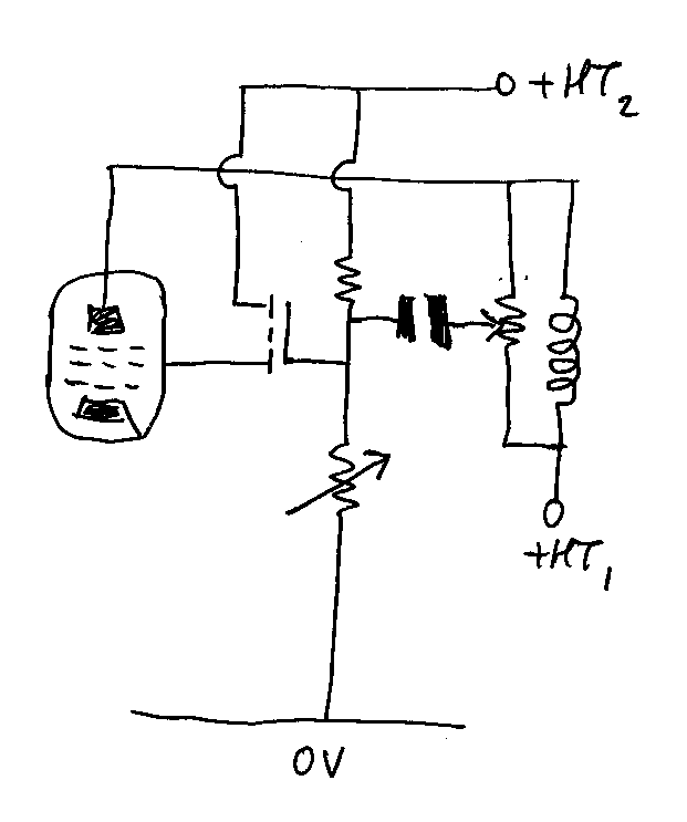

I wondered if it was as easy as all that, so I found an envelope and scribbled on it.
For PP EL84 (convenient example). We would have 10W into 8ka-a. That means 283VRMS across the primary, or 141VRMS at one end. 141VRMS = 200Vpk and that 200Vpk is sitting on the 300V of the HT, so the anode swings to 500V. If our source follower has its drain connected to the 300V HT and we don't like the way input capacitance rises when Vds drops <30V, then it can only swing to 270V. 270V/500V = 0.54. Or to put it another way, we need a potential divider that effectively gives us a maximum of a 54% tap, setting Vg2 = 162V.
Nothing looks unworkable so far...
Edit: From where do you get your Fairchild MOSFETs?
A further thought is that it might be nice to split the AC and DC conditions of the source follower...
Hi EC8010,
I think I bought mine from Mouser: FQP1N50 500V
http://www.mouser.com/search/refine.aspx?Ntt=fqp1n50
Reasonably priced too.
There is also a P-channel marvel too:
FQP1P50 500V
At least an order of magnitude improved specs over any other HV
P-channel part I've seen (there's only two others)
Yes, a good idea to keep at least 30 V across them for low capacitance.

"nice to split the AC and DC conditions of the source follower..."
Yes, exactly what I had in mind.
I've got 100 FQP1N50's on the bench ready to fire up. No problem going MOSFET follower mode here. (and 100 FQP1P50's on the bench for making hybrid Positronic tubes later on!)
Don
Thanks for the source of source followers. They have 250 less than they had a moment ago. International postage being what it is, there's little point in ordering 100 (my default quantity for silicon fuses), and 250 allows for a few ****-ups.
I call that useful.
I've just had another thought. Assuming that experiment confirms smoking-amp's theory, varying the % of the g2 tap should change ra and thereby change the optimum load for maximum power. Looking at it from the opposite direction, you just pick whichever output transformer is handy, work out the % tap required to match your output valve to your load reflected through that transformer and you're away. You can now use any old transformer with any valve...
I'm following with interest the recent posts experimenting with a MOSFET Follower.
Does this approach have significant benefit over the LED or TL431 techniques?
I'm still confused about what sort of voltage drop I should be using on the screen - should it be 50 to 100V below plate as Don says?
John
Hi John,
I guess we have gotten a little off your topic here, sorry. For the original triode trick, I think the idea of lowering the screen voltage below the plate is so the screen will absorb less current and dissipate less power. That way the tube can operate with more power overall if its screen dissipation spec was threatened. Maybe some sonic benefits too, don't know. For this trick a fixed voltage drop should be fine and is easy to do.
The MOSFET follower is useful for the case of dropping the screen some % of plate voltage (for Ultra-linear operation), and for this an active follower is needed from some attenuated plate voltage reference. One COULD use a follower to drop a fixed voltage, but it would be overkill.
