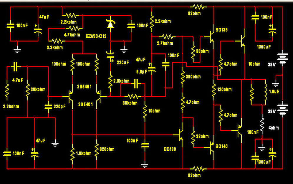

Good schematics, good board, circuit description (brief), parts list will come soon...this amplifier is the last one, my ultimate creation
regards,
Carlos
It is using 2SC5200 and 2SC1943....well, i have tried others, and they worked fine.
But those ones are famous enougth to make people trust.
Also the drivers and VAS can be replaced..at your will.
The input can use BF423, 2N5401, BC556 and BC640...all those i have tested....the better was BC640...i also think that this is very strange.
If you love small increase in treble reproduction (i like that, in special when the amplifier has lovely bass...to compensate i think) install a 103 ceramic or poliester capacitor in parallell with the 1K5 resistor..the one is connected to the feedback transistor base and the other extreme into a 220uf electrolitic.
Emitter resistors removed...the sonic is clear....better with them out! (thanks Doctor Jan Dupont)

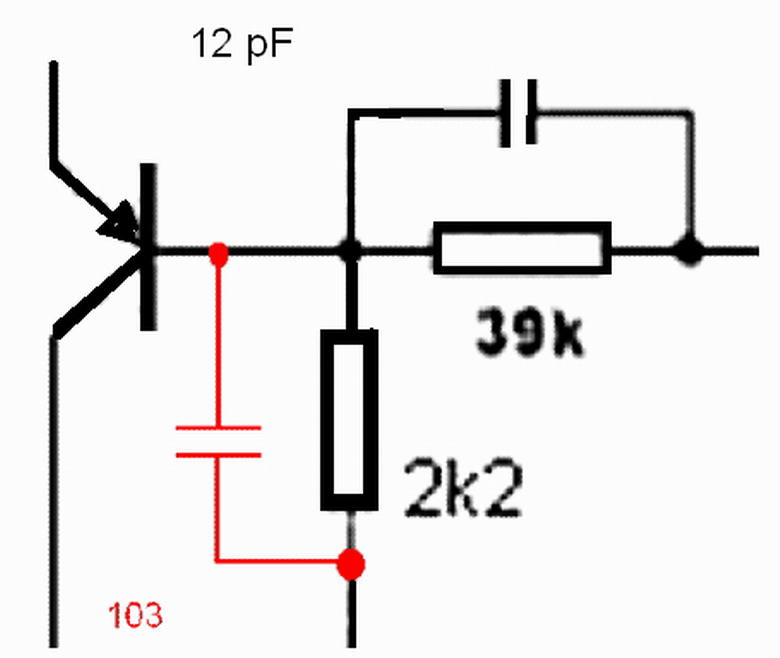

The feedback capacitor (103) used by Graham Maynard was tested, and i could not perceive results...it is used from base to emitter, into the feedback transistor (the one connected to output line througth a 39K resistance in parallell with a 12 picofarads ceramic capacitor)
Everything that did not made difference with test signals...bells wispers, rain, claps, xilophone, violin, guitar scratching fingers, deep acoustic bass, small bells and metal triangle ..... no diference perceive by ears...removed!
Try it Ritchie...100 percent guarantee of satisfaction...it is for free.... BD139 are nice as drivers and voltage amplifier...also the cousins MJE340 (or MJ340 and 350)....TIP31 and TIP32 can be used too...TIP41 and TIP42 can be used too..there are a lot of possibilites to drivers and voltage amplifiers....gain around a hundred and sold them there!
To output you can use the output designed transistors..those traditional 15004 and others from Motorola i think...the TIP35 can be used...also the old MJ3055 and MJ2955 (but you will need
emitter resistor to equalise those guys..you will need three pairs)
The output transistor arrangement may need units that can dissipate 160 or 170 watts continuously.... can be single transistors or paralel ones...using 0.33 or 0.22 ohms resistances into the emitters (worst sonic).
Attention, atencion, atenção, achtung!..... this topologie was used by Mr. Hugh Dean...not the same but almost the same, but all Aksa secrets are preserved...any one of the subcircuits and parts used to increase performance of Aspen amplifiers were used here...Hugh is my friend and no way to stole his secrets....also i use to be a thief only in 32 of February....and if stole something..for sure will be from enemies.
I have tested 25 plus 25 volts.... 35 plus 35 volts.... 38 plus 38 volts and 45 plus 45, this last sittuation using 8 ohms loads.

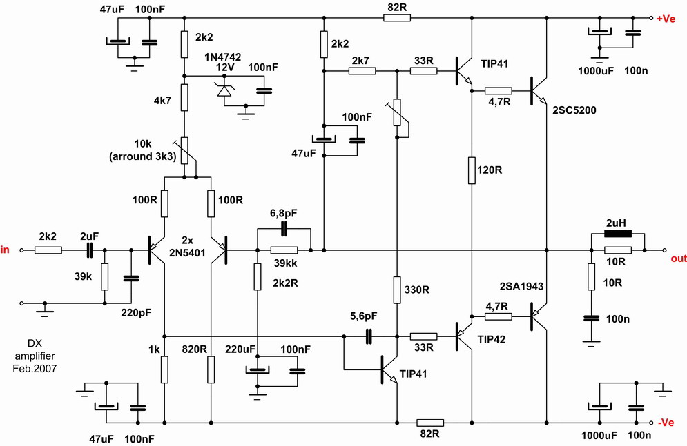

This schematic is a gentle cooperation form Mr. Sparkle.
regards,
Carlos

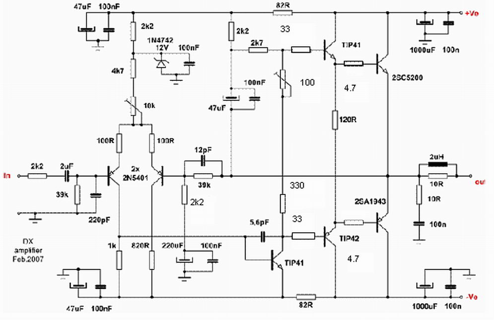

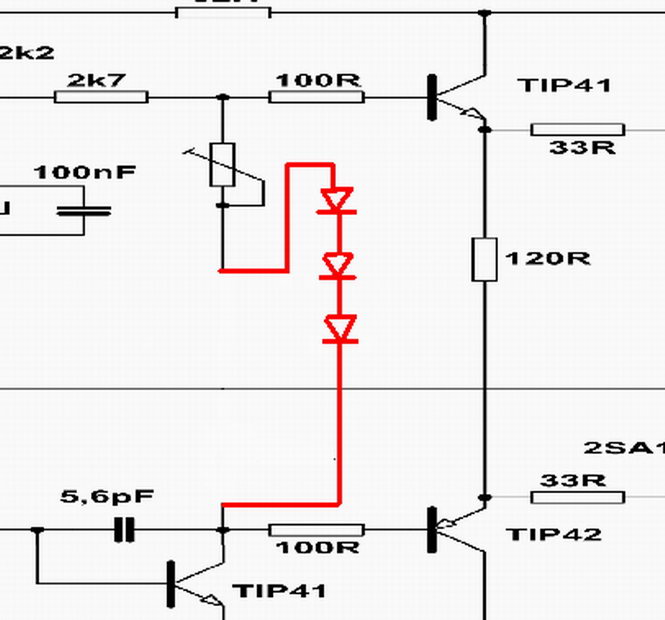

Yes Ritchie..simple, fast to construct and without extra parts.
Using a big heatsink you will be happy, as i could not increase more than 41 degrees in my 29 degrées celsius environment...
the normal volume audition measured 35 degrees.
Also you can substitute the 330 ohms resistor by three diodes in series the way shown...this way you install diodes touching heatsink and the temperature increase will reduce the stand by bias for the output stage...one of the earlier Leach amplifiers used those diodes.
The purpose there is to create, over those resistor extremes a voltage of 2.5 volts or around that...and this will turn on all drivers and output transistors...increasing voltage...the output transistors will receive more bias and will conduct more....when those diodes turns hot...the voltage developed over its extremes goes down... this way you reduce your bias to output stage...this is to the ones that do not know.... i think everybody knows that..of course you know Ritchie...but i have not a "Cristal Ball" to discover the ones are doctors and the ones are beginners..also i do not use to check "who is that guy".... i use to be kind with everybody...from the garbage colector to the Post Graduated Doctor..
Here is the option...i have made that because i have imagined that people will ask exactly you have asked...so..thank you..

I am cooking here today Sparkle.... confort only when i was driving because air
conditioned.... 4 showers todays...a hell hot here.
More than normal.... world temperature is changing and not so slowly as people is telling us....the reality seems to me to be worst.
In front of the beach the protection walls are beeing re-constructed.... waves are destroying and invading the buildings...sand is almost disappearing.... we had 100 meters large of sand last Carnival...one year before now....and today the sand size is not more than 8 meters when the conditions are better (no moon effects)

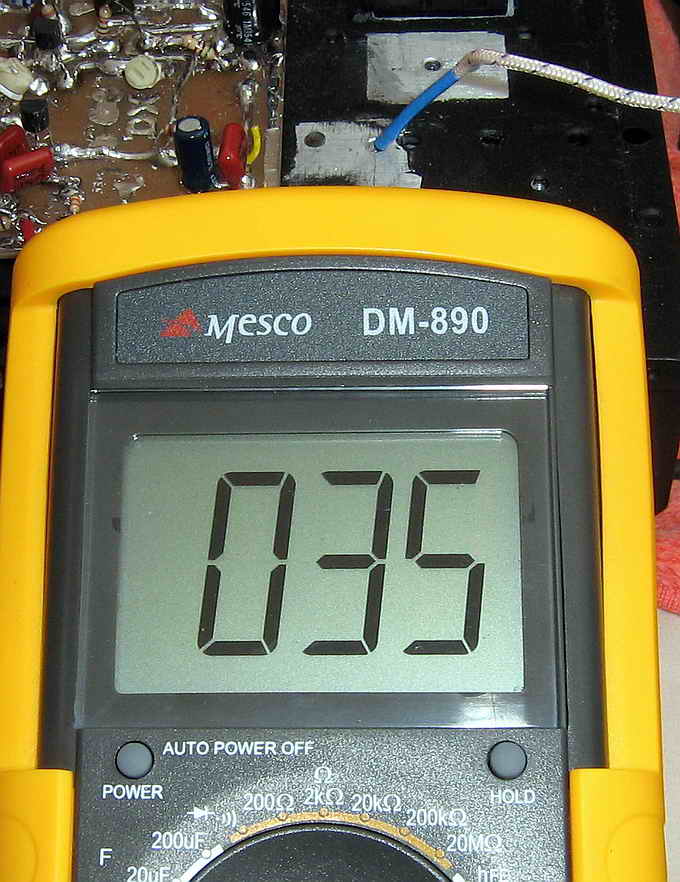

The amplifier is sounding very nice...i am happy with it.
Voltages are wonderfull....VBE are very interesting.... 590 mV to each output transistor.... 575mV to each driver and to input transistors.... 575 to VAS...beautifull...off set adjusted to 300 microvolts.... operating cold...no distortion during very low volume audition....no noise...no thump during power on...no need of Miller capacitor...hehe...fine
