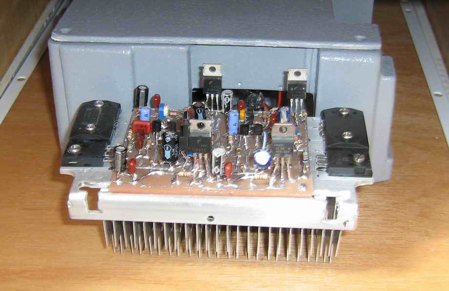

Respecting if PNP or NPN, respecting the voltage limits of your transistor, the
current that they will operate.... selecting if they are Radio Frequency (do not use) or audio frequency the amplifier will operate.
It will operate with fakes, fauses, Junk parts, mismatched transistors will produce some off set to adjust.
This amplifier loves used (and already tested) parts.... have enormous passion by old greasy dirty condenser (you can clean them)
And feel very good if the construction is ugly...it will sound pretty even this way.
And will smash some amplifiers you may compare.... and will be almost so good as the better ones.
Good experience to destroy many myths.
Sorry to remember...shorted transistors will not work...but Germanium ones may operate if you take care with bias....One Germanium to the VAS will produce an incredible nice sounding...try it!...ahahahahah

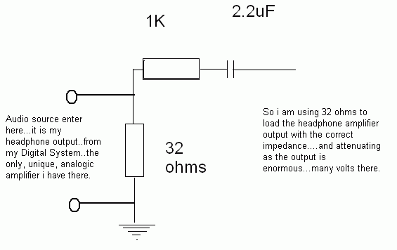

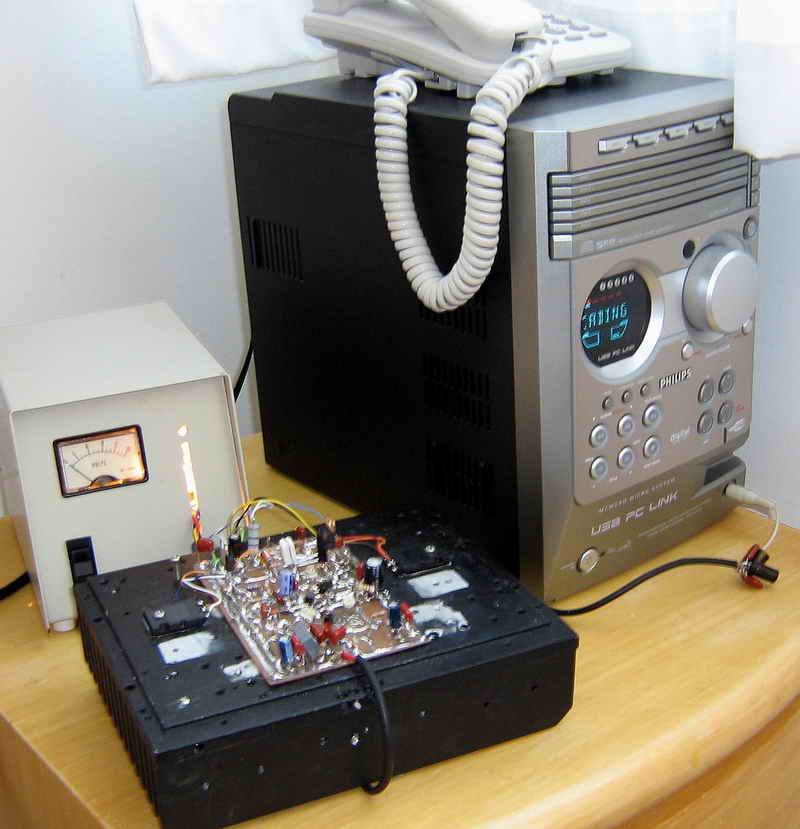

I am using my System's headphone output as my signal source
The headphone output is the only analogic audio i have there...and this output is very good...made with a good Phillips chip amplifier, dedicated to headphones....and there are many volts there...audio volts.
Impedance there is 32 ohms...reason why i am using an attenuator in my own circuit.... customized to my personal needs...this is not shown in the schematic provided.
regards,
Carlos

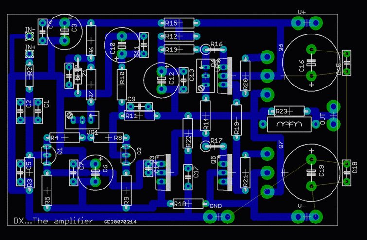

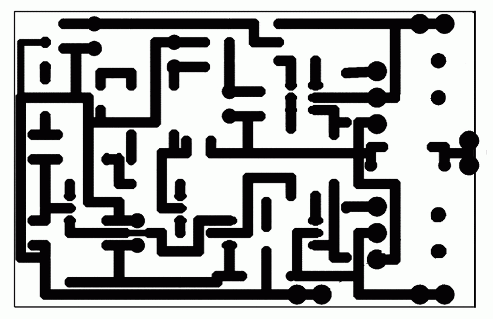

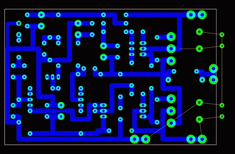

Mr Greg Erskine offered schematic, layout and parts list for us
Thank you very much Greg.... pretty work.
ATTENTION....my error...not Greg error...the VR1 trimpot is 10K..and it will be adjusted to 6362 ohms.
Also intall 1K resistance to both differential colectors..will work sligthly better than 820 ohms.
regards,
Carlos
regards,
Carlos

whoaaa....you are quick.....as someone told - to fast for us my friend.....you should call yourself "Turbo Carlos" not "Destroyer X"....the problem with fakes is not only smaller power that they can withstand but also some change related internal capacitances and this may produce some problems related stability.....that is why i have asked you to tell me if it will be stable with fakes and if i have to chenge some parts in sch if i use fakes....(i believe that in GEM guys have to change some values otherwise the stability of the amplifier is in question - i wonder if this is here the same thing - it seems it is not and that is good)
BTW.... nice schematic.....
Here is the parts list...bom as Greg said.

Here is the black and white image...the black dots at your rigth
Are made to install big electrolitic condensers for rails...i was not sure and i have asked Greg Erskine to let them optional...this way..the ones will use it can use wires to connect them into the supply input..others can cut them out or keep them just as decoration pieces.
Watch the colour diagram and you will see lines..they are for electrolitic condenser connections into the circuit...optional.
regards,
Carlos
