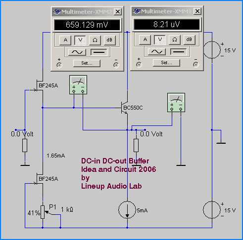

Pedja Rogic JFET Buffer is a good circuit.
Here is my own approach for a DC-in and DC-out Buffer.
I use a one JFET + one BJT Follower.
At 5 mA, BC550C has VBE like +0.660V.
At like 1.65mA, JFET BF245A has VGS like -0.660V.
Add those, and I get 0.000 Volt offset at the output.
The BC550C does what it is best for: Provide current.
The JFET BF245A does what it is good at: Provide High Input impedance.
Circuit can be made very fast. 1 MHz is no problem!
Also shows very nice low distortion, without any feedback.
Most of the low level distortion is in fact 2nd harmonics.
Enjoy :cool:

Thanks Steve... that worked 100%
