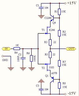

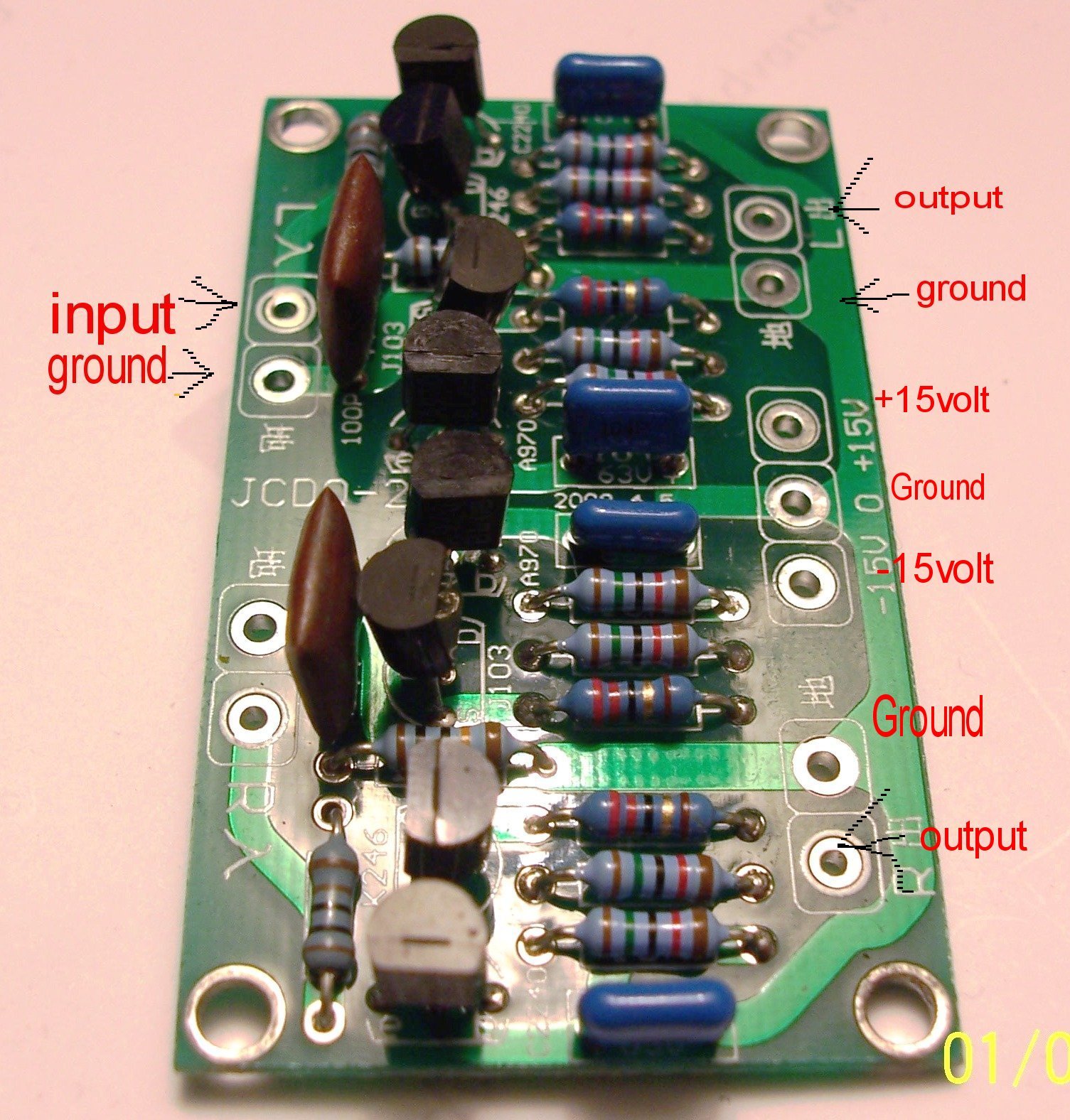

This is the buffer I use in my Dacs at the moment sounds very good I would like the views of the other mender in what they think of the cct
Probably very good if implemented correctly.
It may be possible that a higher current capability may increase performance but that depends on the loads you hang on the buffer output.
A follower integrated into the buffer output could provide that enhanced current capability.

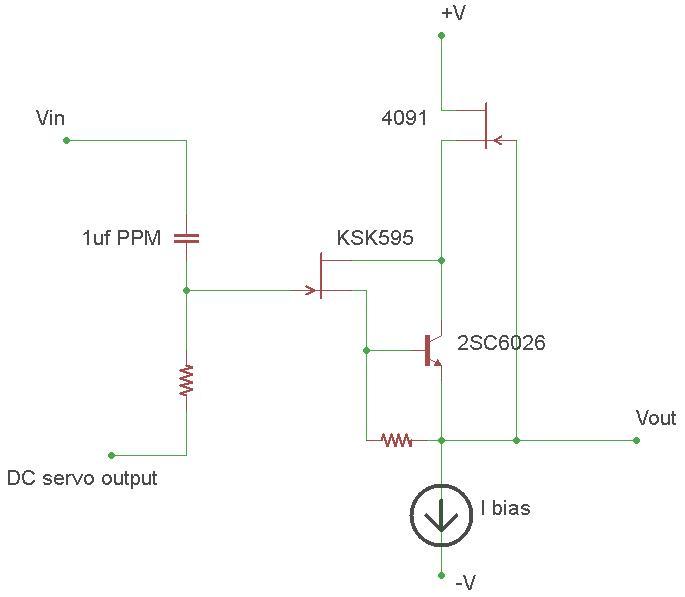

The cascode helps the J-fet linearity greatly by maintaining a constant Vds. The linearity can be further improved by also maintaining a rather constant Id as well. This allows you to set the bias wherever you wish, particularly being able to set the Q-point much closer to Idss, resulting in a lower noise figure for the J-fet. In the drawing below, the AC load of the J-fet is only the base current of the BJT, Iout/Beta(AC). This means you can use an input J-fet that has a smaller transconductance. The circuit is not particular on components, you can use whatever you have that fits. There are some J-fets that have a nice linear transfer within a certain operating area but they may operate with much less Gm, but this is OK here. The BJT and input J-fet is cascode by a high Gm J-fet (simple:) )and the CCS is a medium Gm J-fet bias at Idss. (also simple:D). J-fets can always be paralleled for more Gm. In the drawing, the DC servo input can be set with a fixed resistor voltage divider to provide 0VDC output. The gate of the cascode J-fet can be attached to the input J-fet gate as well, but also adding the Ciss of the larger J-fet to the input capacitance. But this is of little issue since the input capacitance is bootstrapped.:) Having a high input Z allows the use of a smaller input capacitor, which makes more dielectric materials available such as polypropylene film.
