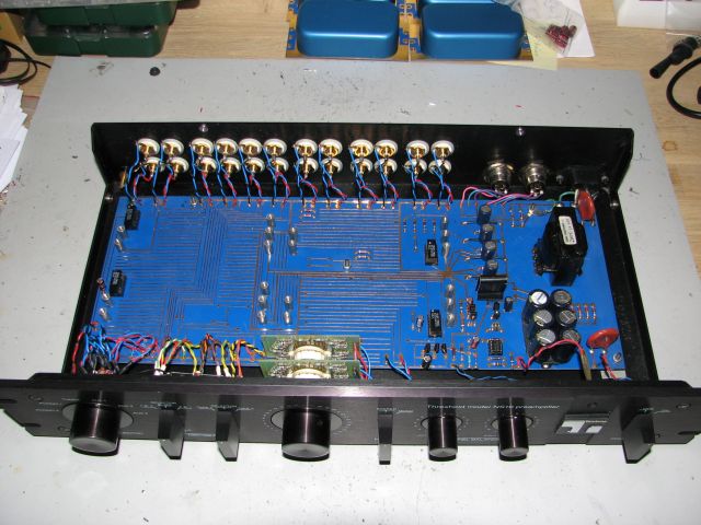

To allow for an easier search, I decided to open yet another thread about the Threshold NS10.
Hoping this might be useful for others, here are the considerations behind the work done.
Some time ago, I was lucky to find a Threshold NS10 for sale with the rare M1 moving coil box in near mint condition. Bought it, and set out to renew it.
I didn’t want to make too big changes, wanting to keep the preamp pretty close to the original.
The sound was a bit dull (dark) to start with. Lacking details in the topend it didn’t produce much soundstage. (Comparing it to the X-CCS-CC-BosoZ,) Something had to be done about it.
Here is how it looked before:
http://www.diyaudio.com/forums/showthread.php?postid=979962#post979962
This is how it looks now (without the shielded modules)
Steen🙂
More to follow.

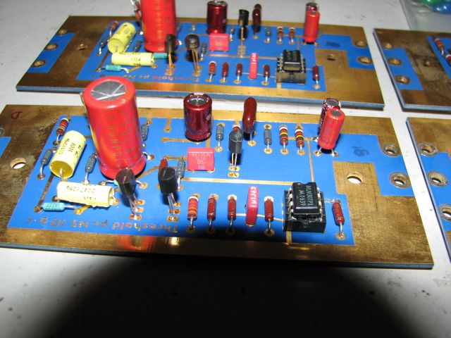

Changing the caps was the first thing that came to mind of course, and this remark from
Mr Pass cleared any doubts one could have about the Tantal caps used in the original:
Last time I encountered a forest of tantalums with some unknown shorts, I hooked the board up to a high current supply and burned them out of the circuit.
All capacitors from 220uF and down are Tantals in the original.
I used the exact same values as the original except for the PSU cap’s before the regulator.
Regarding the input and output caps: Film caps are out of the question. Especially the output caps
of 47uF would never fit in the cans, nor on the boards. Only candidate really is an electrolytic.
I chose Black Gate Non polar for those. I bought those from Peter Daniel, since there is no supplier around here.
The local decoupling caps I used are Elna Starget. I figured that a dedicated audio capacitor would be the best choice in the line and RIAA modules. RS-components stock those.
Capacitors for the power supply were changed to Panasonic FC types. The original PSU had 11oouF in it. Not much by DIY standards, so I upped that to 6000uF. Btw the supply regulation consists of one FT317 for both channels, followed by what seems to be a R-C filter made up of 4 resistors and 4 330uF electrolytic’s, feeding one module each.
The capacitors in the RIAA eq. circuit are Polystyrene/foil types, so no need to replace them. Thanks to Malotron for the info on that.
This pic shows one of the modules with new cap's installed. I let the 7pF sit since its a dipped Mica.
Still more to follow.

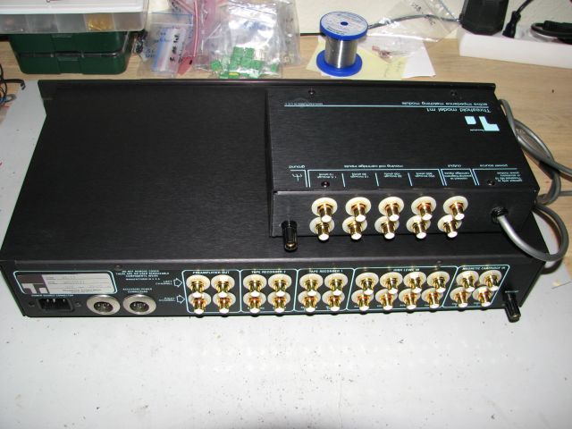

All the RCA sockets were changed to gold plated/Teflon insulated types. 17 pairs are needed to replace them all, including the M1 moving coil box. I didn’t want to change some of them only, since the preamp would turn out ugly. I am never going to use the Tape connections, though.
The signal wiring was all changed to OFC/silver plated/Teflon insulated signal wire.
All the internal signal wires had a ground wire twisted around it, I stayed with that procedure.
The volume pot of the original was changed to an Elma gold plated attenuator. The attenuator uses good old Phillips metal film 0,6Watt resistors.
The previous owner had already installed new balance pots, and I decided to let them sit for now.
Everything else was cleaned and polished, especially the standoffs holding the modules. They actually acts as connectors to the main pcb! The ends of the standoffs were somewhat tarnished, where they meet the module pcb’s. I thought it well worth doing that, of course.
It was very tempting to disconnect the tape selector and tape loops together with the balance pots, since this would shorten the signal path considerably, but I resisted since it would also change the original design too much for my taste.
Here is a pic from the rear with the new and shiny sockets:
Still more to come.

So how does it sound now? In one word: Superb. I was very surprised to find that the difference was so big. The sound is now crystal-clear and detailed. The soundstage is tremendous. I guess all the little things done, added up to a really good result. Both the Line and the RIAA sounds good. The RIAA was not much to write home about initially, but now it sounds fine. I like to think that this is how Mr. Pass meant it to be sounding from the start. I want to add though, that I think the NS10 might be a little unforgiving. If you have some weaknesses in your playback chain, I don’t think the NS10 will do much to cover it up! (Like a BosoZ tends to do) If your phono-cartridge is a bit “ringy” in the topend, the NS10 will let you know without mercy. Right now the NS10 is connected to the Babbelfish (Aleph-J clone) and the combination is just great. The NS10 drives the Babbelfish with real authority (better than the x-bosoZ used singleended-out) I like this preamp more and more.
20+ working hours and 300USD later you might want to ask: Was it worth it?
The answer is: Absolutely.
Steen😎

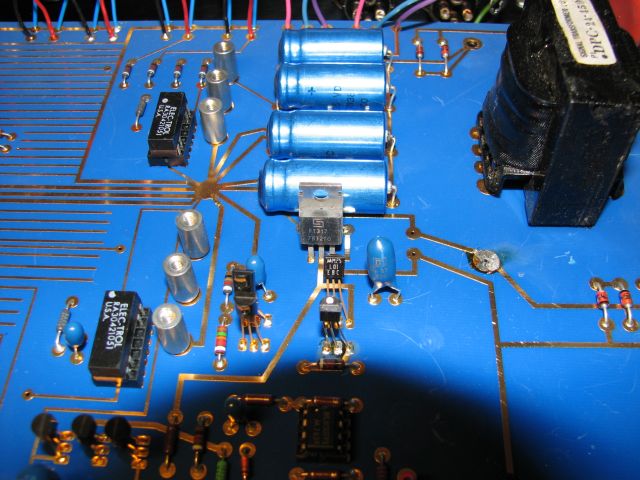

Could you attach an image of this board?
thanks
Piero
Thanks,
It is made by Solid State Inc.
the first line is FT317, I can't read the second, maybe 7812TO.
the code seems voltage regulator... but are you sure?
Those parts are also inside old threshold Amps (FT317 & FT417) but there's a bit of confusion about them: just searching the forum.
I have FT317 7807TO, FT417 7907TO and FT317 7807 in the same amp. An old post consider a good substitution of them with MJ 15030/31... these are NPN and PNP drivers and surely not regulators.
Piero
I am pretty sure the FT317 is an adjustable voltage regulator😉 Its known as a LM317 these days. The family starting with 78 or 79 that you mention are also voltage regulators, but fixed. A 7812 would put out +12 volts while a 7912 would put out -12 volts and so on....
Steen🙂
