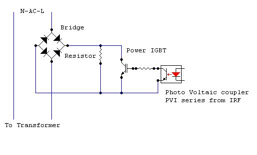

Here is my idea....simple version using IGBT as a switch and Driving it from PVI coupler, just an idea...only
for PVI have a look at this
http://www.irf.com/product-info/datasheets/data/pvin.pdf
The LED Trigger circuit could made easily with few passive components for working from mains directly
K a n w a r

Then you end up with 2V @20A drop from the diode bridge plus another 1.5V @20A from the IGBT (assuming a standard speed one is chosen). Compare that to the 1.5V @20A from the triac, which has no rival when it comes to solid state switching of AC mains. If you want optocoupler triggering, consider a MOC3020 optotriac, and note that it does not require an additional power supply.
