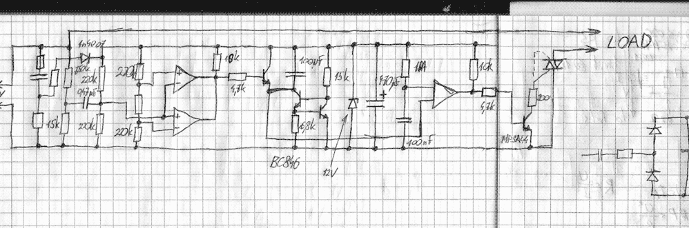

Hi everyone, this is mine attempt at this.
Input is a window comparator controlling a transistor which shorts the cap during zero crossing so we can have a nice inverse ramp, which is in turn is compared with slow ramp from another cap charging.
So far I need to verify triac triggering, power supply and possibly make an on/off toggle button from a last comparator of LM339.
The overall cost of the circuit is like ~2 euro if you have a normal local retailer.

VEC7OR said:Um what is this thing below exactly for ? What does it control ?
Sorry, forgot to connect the gate. The FET doesn't operate in the linear region, switches on at the zero crossing. See Pressman cited above.
