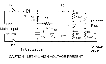

Internal shorts in NiCad's
I believe that the internal shorts in NiCad cells slowly decrease their capacity till they become useless.
I came across an article sometime in the late 90's ( could have been ETI from Australia) which removed these shorts. The method was to charge up a small capacitor using mains and discharge this through the battery which burns up these shorts. Of course only one or a few shorts burn up at a time. So you have to zap the bettery many times to burn up as much of the shorts as possible.
The capacitor is small in value so it hasn't enough charge to damage the battery.

I see that there are people for and against Zapping a dead cell.
However please note that they use the term Zapping for two totally different processes.
1. They use very large capacitors like 40,000uF/70V and discharge it across a cell. This can cause heating and possibly other damage if done excessively ( explode !?) .
2. The ( safe!) version that I tried. It uses a small cap (1uF?) at rectified mains voltage ( 380 V ) to zap each time. The energy of the discharge pulse is much smaller.
I'll put up the circuit in a day or two.
( NOT MEANT FOR NEWBIES . 380 volts can kill you if you make mistakes!) However the unit is designed fairly safely . The mains is disconnected before zapping.

Caution ! Caution ! Caution !
I cannot find the magazine article but I did find a zapper that I made. I have no idea what changes I made , if any. It does zap the battery. I can't test the current unit as the capacitor has leaked and needs to be replaced.
There is HIGH VOLTAGE everywhere so if anyone tries it use CAUTION>>>CAUTION>>>>CAUTION.
Stand on an INSULATED surface and use just one hand. The unit better be fixed to a base board and you shouldn't need to touch it except the switches . The push button and power switch MUST be insulated types with plastic on the operating surface .
Some details;
PO1 , PO2,PS1,PS2 are the poles of a DPDT switch. The poles are all independent of each other. So that makes eight terminals on the switch , four on one side and four on the other. Flip the toggle one way and PO1 and PO2 are open and PS1 and PS2 are closed and vice versa.
S1 is a non locking push button.
D1 is a 1N4007 diode .
D2 is not an LED. Its a NEON LAMP.
C1 is a 32uF / 450 volt electrolytic cap .
All resistors are 1/2 watt .
Output to the battery to be zapped is taken across R5 . My unit has insulated crocodile clips on 1 foot long leads.
The power switch charges the battery when PO1/PO2 are closed. This also isolates the output from the high voltage on the capacitor or the mains. Switch it the other way ( PO1/PO2 now open and PS1/PS2 closed ) and the unit is ready to Zap. Push the push button S1 and the battery gets a high voltage impulse through the SCR . The SCR on my unit is marked TY4004 . I guess any 600 volt 3 amp SCR should do.
THIS IS NOT FOR NEWBIES and in any case needs lots of CAUTION when using. Note that a battery needs to be zapped many times because it burns off only a few shorts with each Zap. Maybe 10 to 50 times to be really have some improvement I think.
