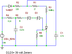

A simple multiple burst zapper.
I came up with a very simple circuit yesterday.Something that uses very few parts but needs careful handling.
One must be sure of not handling it when plugged in.
Some sections are incomplete. The charging cap needs a bleeder resistance with an led to indicate when it is discharged ( and safe to touch ). The battery is no longer grounded at one end.
It generates pulses with each mains cycle and so at 60 Hz it will give 60 pulses per second. Pulse duration is very short. Current peaks are close to 9 amps controlled by the 33 ohm resistor. Making it larger will reduce the discharge pulse current. Pulse voltage will be quite high. Over 100 volts.
I haven't tried this yet but will probably do it very soon.
Edit : The mains supply shown is wrong. It is 120 V/ 60 Hz and not 230 V !
For 230 V /50 Hz the gate trigger circuit will need R4 to be altered to 22K.
