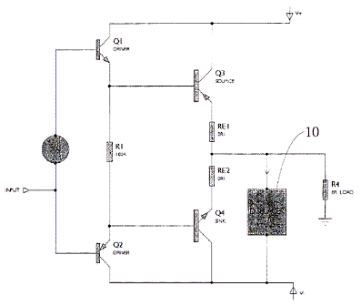

How can Douglas Self patent an idea he has already disclosed!? :D
The picture is from his homepage.
What I can see is a modulating CCS in the lower end reminding of Class XD, though I can't be really sure as I have not seen his schematics yet.
Cheers Michael
PS. EDIT: Funny the picture gets 3 times bigger when inserted here while it's only 300x400 pixels at his homepage??? :confused:

For several years the Class AB "X" series from Pass Labs has biased the output stages with single-ended current sources,
but we also run a heavy push-pull bias on the followers. The results are much better than using a Class B output stage with a single-ended current source.
Hi, Mr. Pass,
I don't understand this. Heavy biased classAB is better than classB,.... OK I got this.
But I dont understand this. Is there a connection between classB or heavy biased classAB with type of VAS load? I assume single ended VAS comes from single differential (the load for VAS is CCS), and push-pull VAS (no need for CCS) comes from complementary input differential. Is the type of VAS got something to do with how much bias needed at the output stage?

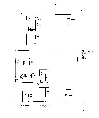

And here's the actual crossover displacement circuit for the lazy ones who don't want to dig up the patent... :)
Reminds a bit of the circuit I attached in post #6, with the difference that it sensed the current while Class XD senses the voltage.
Cheers Michael
