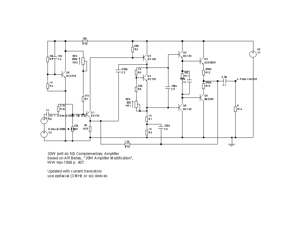

Another thought ...
Back in 1968 Arthur Bailey published a circuit for one of the first complementary power amplifiers. Anyone remember this? It appeared as "30 W modification" to his Wireless World 30 W circuit, and republished in "High Fidelity Designs" in 1970. It had 40361, 40362, MJ481 and MJ491 in the line-up.
It is a most interesting design because it did not have the usual feedback decoupling capacitor in the input stage. Instead it used a thermal bias compensation transistor. The feedback resistor was taken from the output rail, sitting at around 30V, down to near ground through the un-decoupled feedback attenuator (gain) resistor. Bailey said "if anything, this amp. runs better than the original". I took a look at this some time ago and realised that the current taken by the feedback resistor (1.5kohms) forced the upper output stage into class A. This according to my simulations reduced the crossover distortion a little.
Predating XD?
cheers
John

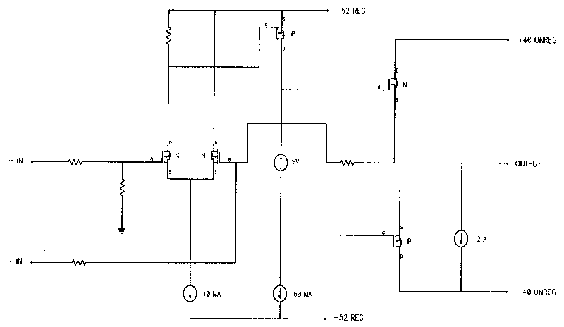

The work of Nelson Pass appear appliying ante litteram "XD" principle while the same can't be told about the Bayley circuit.
However... I, without any claim of inventing anything of new (because there is NOTHING of new in these things), just apply this "new class" from a dozen of years in forcing some of my op-amp circuits to work in class A in not extreme loading condtion. I'm just amazed of the rumors on what, at the end of story, is just a very *trivial* (and somewhat unelegant) idea... Is just a trick, not a "new class".
