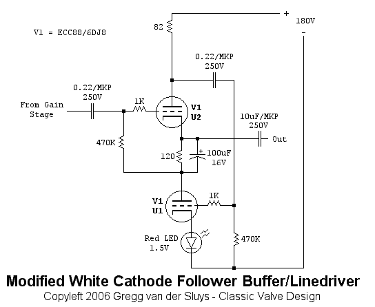

Great idea to start a topic here 😀
I have a design in mind, but without an actual SEWA present, I can't say if it will work to perfection.
If I am correct, we need 25V P-P driving some fairly hefty Cin on the MOSFET. Driving the capacitive load isn't an issue for what I have in mind, but keeping it stable with no feedback loop.

Thanks Geek.
My own thinking, based on what little i have seen and read about tupe preamps, is 6922 / E88CC / 6DJ8
Not a very original thought, yes,
but this these tubes has made a lot of good and many people happy.
And is easy to find and buy, to a resonable price in most countries.
Cin is typically 250pF because of the common drain connection, look at the Crss curve of the mosfet for this figure (about 250pF for IRFP240 @ 15VDS) 😉

Anyway, this is what will drive it. Yes, it's an ECC88 and if you want to use a 6922/E88CC, it'll need changes.
I haven't done the gain stage yet... backed up on projects.
It uses lower voltage and higher current. I've used this as a straight buffer and is stable into a 4.7uF load, as well as complex weired inductances. It'll also drive fair good. Not as good as two trioded 6EJ7's in mu-follower, but it'll swing 25V P-P across 2K resistive+capacitive okay.
So, three tubes. One 6DJ8 for each channel and a third dual-triode for the gain stage. I'm thinking 6CG7.

Mad_K said:
Cin is typically 250pF 😉
Very cool. I assume this takes into consideration Mr. Miller's contribution?
I think we can disregard him for this Common Drain circuit 😉

Requirements:
+/-20V voltage swing
Able to drive 47K, 250pF
10-20X Gain
Volume control
Source selector
Low noise

I presume the work/money would have to be spent on the PSU
A big saving could be made if using a MR psu. (Minimal reactance psu) like one that Dave Davenport developed. After the rectifier one cap -> one CCS..voila.
My suggestion based on those requirements would be to build something like Douglas's (Sector7G' or Bandersnatch on diyAudio.com) Guinevere but with (a minimal reactance psu - not shown here yet). And instead of the relatively hard to get depletion mode mosfets use that IXYS 10m something part. Tube could be 5687 or the 2 dollar supertube 6n6p. (Or many other tubes for that matter)
Compromised URL removed by Moderation
One tube socket. One dual tube. 3 Single chip CCS's. (If using the IXYS jobbies and the MR psu.)

BAS,
How much current is each section drawing? (even if i wasn't half asleep i'm not yet able to look at the circuit and figure that out). The IXYS chip has a minimum of 10 mA.
dave
dave
Around 15mA per channel.
