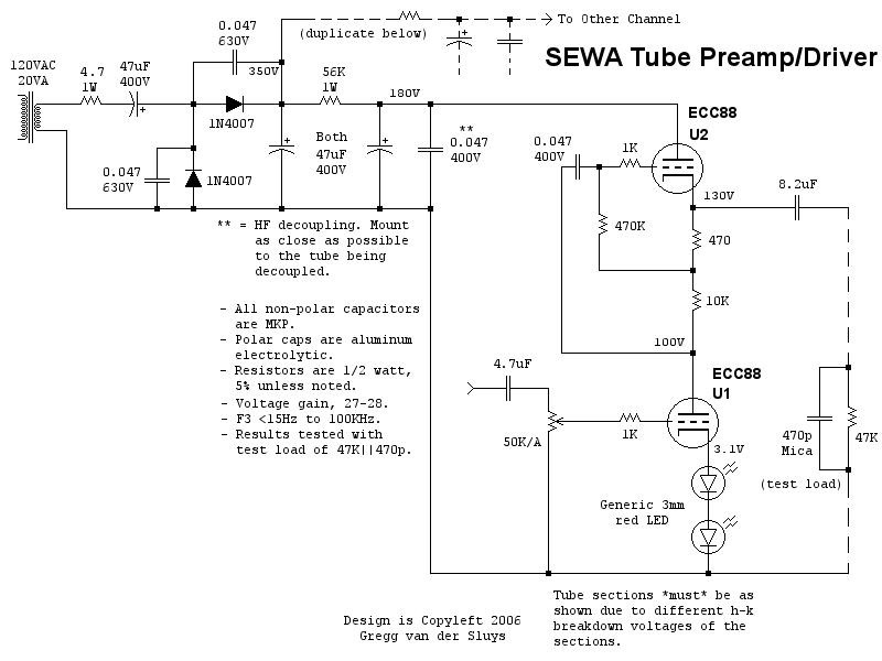

meanman1964 Member Joined 2006 2018-01-23 3:34 pm #281 2018-01-23 3:34 pm #281 meanman1964 said: How much is the output voltage of this pre amp ? Click to expand... No one ??? ••• More options Share meanman1964 Member Joined 2006 2018-01-24 7:31 am #282 2018-01-24 7:31 am #282 Sorry , I mean this one Attachments sewa_ecc88_driver.jpg 62.5 KB · Views: 210 ••• More options Share meanman1964 Member Joined 2006 2018-01-24 3:19 pm #283 2018-01-24 3:19 pm #283 Find it myself ••• More options Share T Tyimo Member Joined 2002 2018-01-24 5:31 pm #284 2018-01-24 5:31 pm #284 Hi! Sorry for the late reply, but I did not find this thread in time. I thought it is in the Tube forum.... I would suggest you to use a simple transformer coupled Triode voltage stage with 6N6P tube! greets: Tyimo ••• More options Share meanman1964 Member Joined 2006 2018-01-25 8:05 am #285 2018-01-25 8:05 am #285 Tyimo , How much is the rail voltage of the tube sewa pre ? ••• More options Share T Tyimo Member Joined 2002 2018-01-25 3:58 pm #286 2018-01-25 3:58 pm #286 The power transformer's sec. is ca. 140-150Vac and after filtering you should get ca. 180Vdc Last edited: 2018-01-25 4:10 pm ••• More options Share Prev 1 … Go to page Go 13 14 15 First Prev 15 of 15 Go to page Go Show hidden low quality content Status This old topic is closed. If you want to reopen this topic, contact a moderator using the "Report Post" button. Share: Facebook Twitter Reddit Pinterest Tumblr WhatsApp Email Share Link
