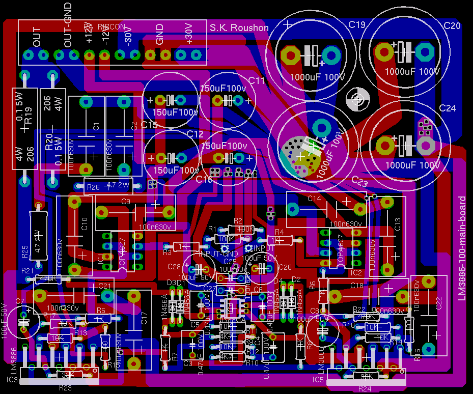

PCB design of parallel of two inverted LM3886 with buffer and dc-servo.
I already put the PCB design in the thread `Bridgle or Parallel" where I had put the circuit design sometime back. But as I need suggestions and corrections for the circuit and the pcb design, I thought I should start a new thread with a different title.
The links are:
Cirsuit. http://www.diyaudio.com/forums/attachment.php?s=&postid=529675&stamp=1102598305
Power Supply.
http://www.diyaudio.com/forums/attachment.php?s=&postid=537485&stamp=1103622043

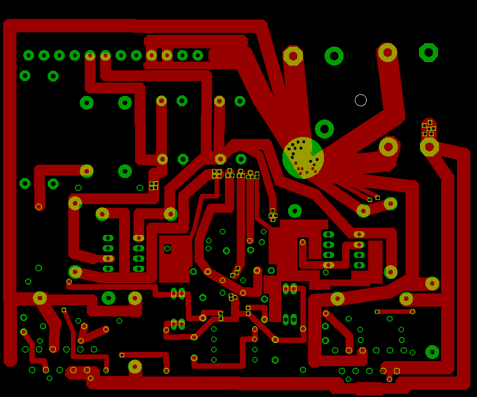

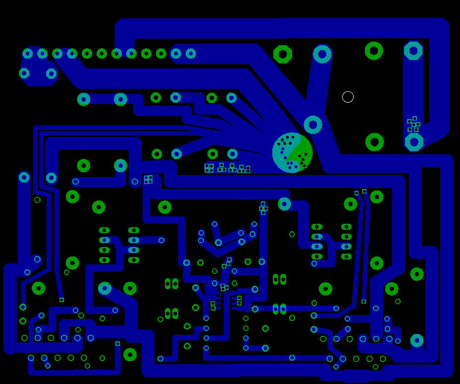

A .png file of the PCB.
http://www.diyaudio.com/forums/attachment.php?s=&postid=971042&stamp=1154059199
Top side of the board:
http://www.diyaudio.com/forums/attachment.php?s=&postid=971043&stamp=1154059264
Bottom side of the board:
http://www.diyaudio.com/forums/attachment.php?s=&postid=971044&stamp=1154059327
I will make the following changes in the circuit/pcb suggested by Gajanan.
1. move the parts away from the heat sink.
2. place several PTH in power line wherever it ocures.
3. take the outgnd from one of the filter capacitor.
I will also redesign the circuits around the regulators in the PS to meet the minimal load requirements.
If you see any more troubles or mistakes with the circuits or PCB please point out.
thanks
Roushon.

There are some thing I really do not like about this schematic.
Why would you want to use 2 paralell input buffers??? I see the idea of using paralell LM3886, since you get more power. But you should consider feeding them from the same buffer.
Even though both buffers are identical, there will always be some difference due to production tolerances. And if the 2 LM3886's are not driven be exactely the same signal, the will work against each other.
Also you should consider using only 1 DC-servo for the system. Not one for each LM3886. Paralell circuits will always try to correct each other, and therefor work against each other.
Also consider using a low speed op-amp for DC-servo. Like LF411, OP177...

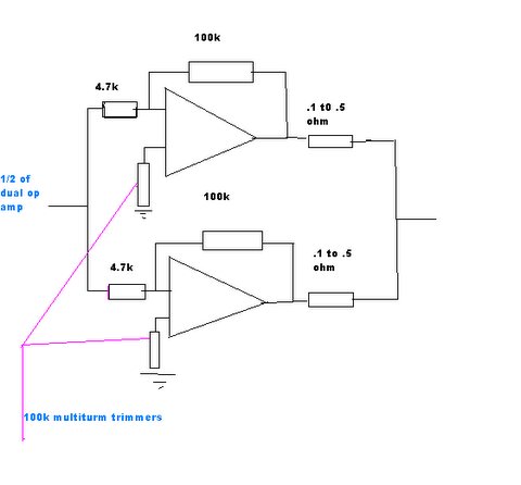

If you are still interested
This is the simplest way to parallel lm3886 chip. There is no servo, they are not needed.
Use one half of a dual op amp per channel. The value for the resistors is up to you, I use 4.2K.
Two pins of the trimmer are connected together and one pin is connected to ground.
Before connecting the outputs check, each chips dc. Turn the trimmers until dc is zero out or as close to zero as you can get it (usually around .1 to .3 mv). Now connect the outputs together
Thanks a lot for your suggestion. But if the dc is made zero by this procedure, I do not know whether it will have some negative effect on the sound quality. I am curious because I have not seen this method before in any of the application notes of NS. There they always suggest to use a dc-servo when paralleling.
In any case I will try it also.
The value for the resistors is up to you, I use 4.2K4.2k and 57.7k resistors
Two pins of the trimmer are connected together , then connected to the (+) signal input and the third pin is connected to ground
I have not heard any negative effects
Hpfully final!!
Spent a lot of time for this revision of the pcb. Please give me your opinion. Tried to follow the application notes and some suggestions I received here. The pcb looks very complicated, but I hope it is a good design.
zobel
there are Zobels added in the pcb which are not there in the circuit diagram. also as I do not have enough low voltage 0.1uF, I had to use those fat ones (panasonic 0.1uF630v) that made the board a bit big. AD8620 is placed on the bottom of the board.
