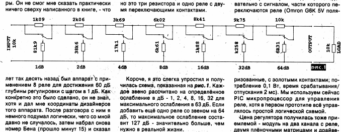

Still fighting to get things right. Removing the 100R made everything fall
apart, but I am sure it will pay off. Tried to pull down the input of LM3886 by
10K to ground, did not work. Next removed the attenuator, connected the
amps directly to the output of buffer and used the sginal source (an AIWA CD
player) volume control to raise the volume. Then absolutely no noise and
both the channel played smoothly. Now (reluctantly) trying to shift the
attenuatur to the input of the buffer. Can I keep the attenuator in between
the buffer and amp after making some changes? I will attach the attenuator
circuit in the next post.
Regards
Roushon
The attenuator circuit is attached. This I downloaded from one thread in this
forum. Do not remember the thread.
Roushon
attenuator shifted
Finally checked after shifting the attenuator at the input of the buffer. No problem
now, the sound is excellent except for two minor issues:
1. Need to raise the volume almost halfway to make the amp audible, which
I do not mind much.
2. On and off a motorboating sound appears in one channel (this is the
channel which was picking the RF before removing the t-network). I hope a
rewiring will solve this problem.
Thanks a lot to everybody who posted in this thread for help and discussion
and of course I am very grateful to this forum where I began and started
learning from scratch.
Regards
Roushon
