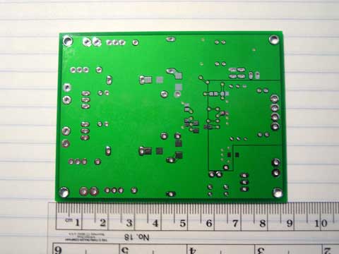

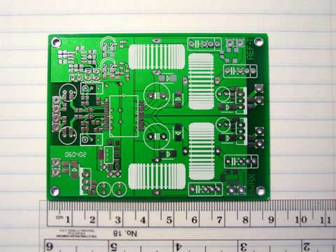

Enough chat, here are a couple photos of the board.
This one is the top side.

Nice symmetric layout, large ground areas, good job. I have no criticism till I actually try and build one. It probably would be best supplied with the 2021 installed. This would be the place I would think most errors would occur.
For most DIY’ers the problem sourcing things like a nice metal case and matching knobs is a problem. If you could offer these things it would make the overall project more attractive. I have a source in Taiwan that will make cases to spec and from the quality and looks I have seen this might be a source for you to consider. Here’s a link;

Thanks for the replies guys.
I'm hoping a good low noise 5V regulator helps expose some hidden potential as well! Mylar output caps eh... My plan was to go with some nice polypropylene or polyester film caps since they're not too expensive and are great for the intended purpose. All the surface mount footprints are 0805 and larger but you can easily fit 0603 parts on the 0805 footprint I used for the board. It's all about flexibility.

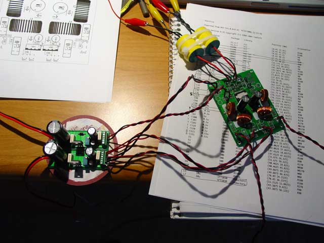

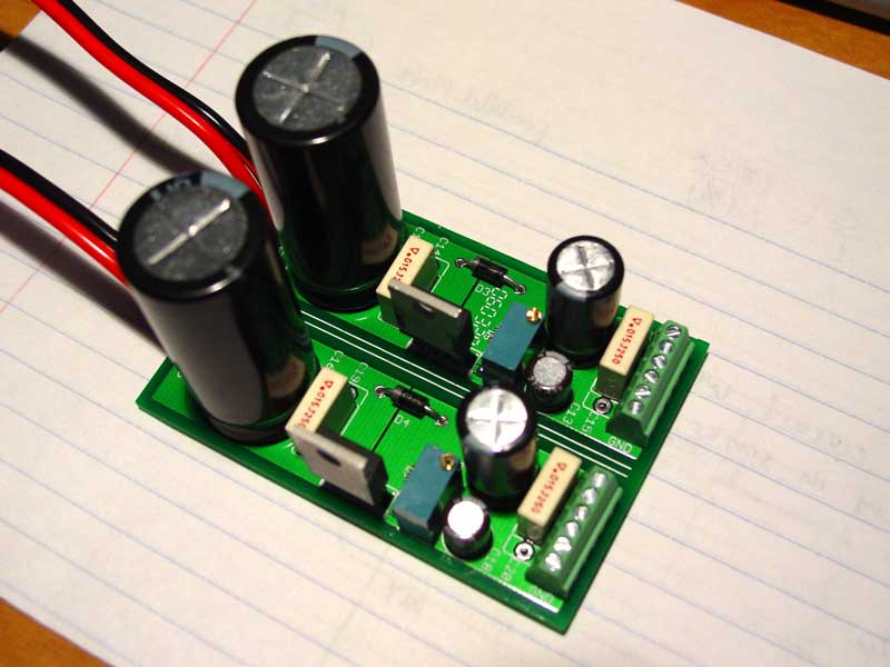

I haven't started to populate the Ref-T board yet (although I do have enough parts to get one up and running... I think), but I did build my regulated supply today. I made this board as well.
The LDO linear regulators are the inimitable LT1085 from Linear Tech. The input and output caps are 3900uF and 680uF Nichicon HEs bypassed by 0.015uF polypropylene film caps.
I designed the board to have three sets of outputs so I could jumper one regulator to each of the three 14V supply inputs on the Ref-T board in case my independent supply idea doesn't work. Pretty slick, huh? 😎

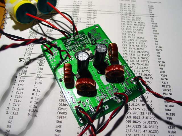

Micheal gave me a couple links to places that can do assembly. It costs more for through hole and fine pitch SMT parts. If I can get the boards made with all the small surface mount parts done I can put the chips and the through hole parts on myself and probably save a bit on the overall cost. I haven't had time to get a detailed quote just yet as I haven't even built the current boards! The iron is fired up and ready to go though. Time to head down to the workshop
She's alive! It makes music and it sounds quite nice. It's rather noisy though for a couple reasons. Reason one, the signal and speaker outputs are connected by alligator clips (albeit silver stranded audiophile quality ones 😉 ). Reason two, I have wires everywhere and the setup is next to my computer and halogen lamp. Reason three, there are no caps in the output filter! It's running with only the inductors. I took them in to work today and measured them and they are 13uH at 100kHz with 41 turns on the toroid core. They're the same inductors supplied with the amp3 and amp6 kits from 41hz.
Regardless, it sounds nice with a wallwart for the unregulated input to the Vdd regulator and a 9V battery before the 5V regulator (that might be another reason why it's rather noisy). I can tell channel separation is already a bit better as the imaging is very good.
