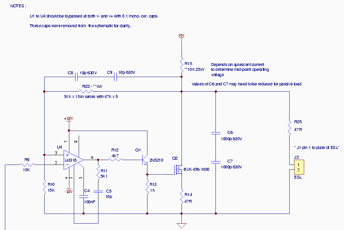

Again, i am posting the schematic of Neil S.Mckean with some questions:
What is the purpose to use Q1 to drive Q2 ? It cannot produce more current than LM318 does(around 20mA).
Another question is what C4,C5 and R11 does.It is kind of compensation ?

Hi Victim,
don´t guess..read! "Simply because they offer a superior signal handling in togetherness with an simpler and more straightforward design." At KR they´ve tried out several tubed driver topolgies, but always came back to the MOSed driver stage because of its simplicity and superior performance!
