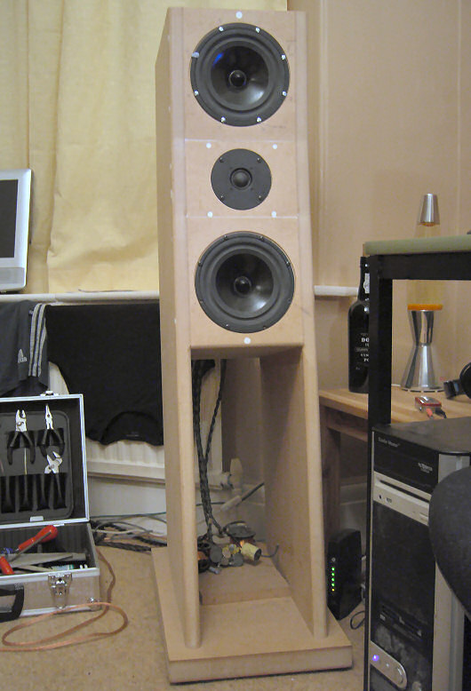

I've decided I'd like to augment the low end output of my speakers, as I feel they slightly lack authority and weight in the bass.
Currently the system is pre and power amp with 3db baffle step correction, feeding 2 way MTM floorstanding speakers using 6.5" Seas coated paper drivers (3mm xmax one way). These are ported and reach 40 or 50hz in-room.
A 15" (260L ported Tempest) subwoofer nestles in underneath from 50hz/45hz (two x-overs to attain 4th order).
This setup is quite good but lacks a bit of slam in the mid-bass range. I don't feel these Seas drivers are up to the task, and would prefer to be relieved of the load, and purely work on midrange.

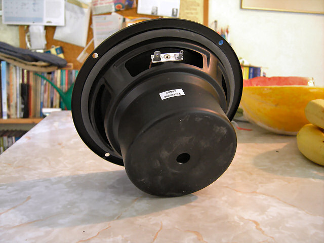

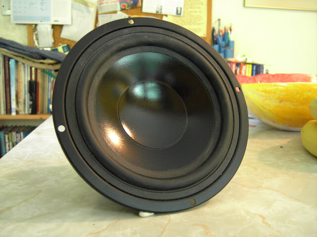

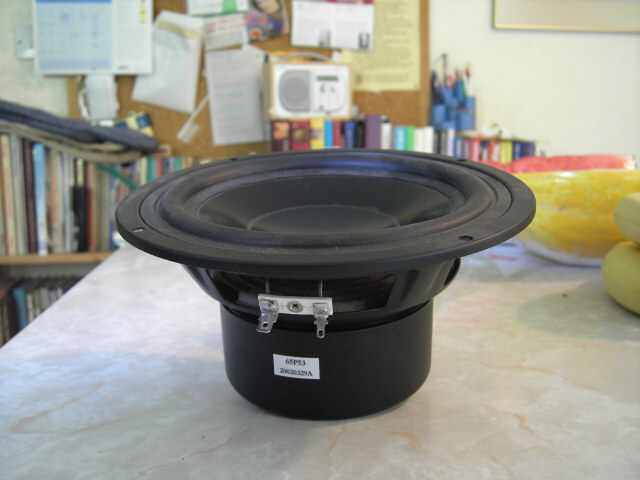

It just so happens I have plenty of seemingly suitable 6.5" drivers lying around (100+), which I bought from Acoustic Solutions via Ebay.

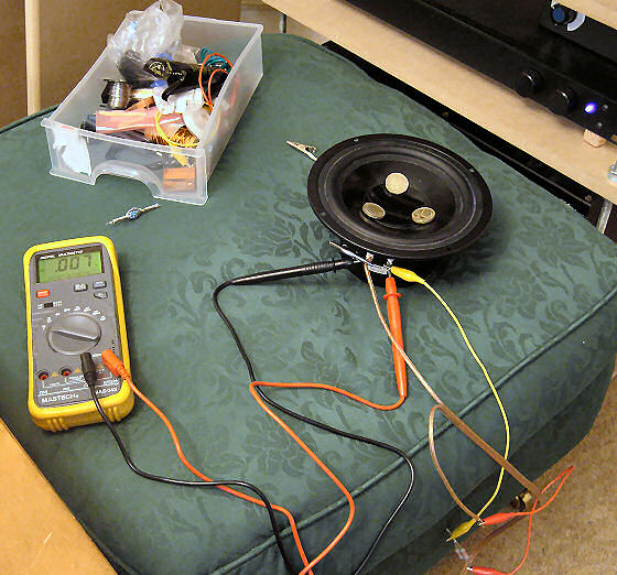

I *fiiiinally* got around to having a good go at measuring their impedance curve. My previous excuse not to was my DMM could only read 0.0vac, but I recently bought one that can do 0.000vac. The measurement technique used called for 0.0000vac to be accurate, and indeed the measurements seemed somewhat erroneous. So I calibrated the voltage to 10x the level shifting the decimal place to the left. This gave me believable results.
I left them at home (oops) but the Fs was 43hz, Qts 0.4 or so, and Vas 20L iirc.
My intention is to have a go at installing some of these units in the space allowed by the integrated stand of my speakers. I have modelled them in WinISD pro Alpha and they seem quite useable.

I will upload some winisd screenshots showing the responses, and also pics of the driver and the system in its current state.

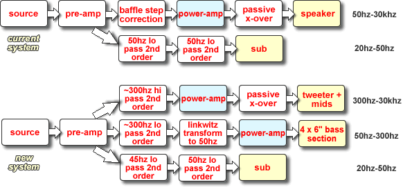

Whatever I do, I want to go active and add extra bass drivers, because this will achieve the following:
* more headroom and max spl
* more bass output
* lower distortion midrange and even treble
* a separate bass section allowing room correction EQ (at some point), which won't interfere with the midrange and treble
* a closer match with the output capability of the sub
* a closer bass character match with the sub (hopefully)
Currently the speakers aren't too great for parties or loud home cinema, as they simply don't have the displacement (perhaps not enough amp either). They start to sound a little weak and strained when the dial goes right to the end!
At the moment I'm using about 25w worth of LM3886 (a sort of semi-permenant prototype). I am about to build a better LM3886 with about 50-60w output. This would power either the top or the bottom. In the meantime I have a Roksan Caspian I could use for part of it.
I would mount the psu and circuits for LT and active x-overs in the pre-amp chassis (Rod Elliott Project 88 in 1u rackmount case).

SimontY said:Hello,
Here is a flow chart making clear what we're talking about doing.
Flow chart! You're not a management consultant are you? 😉
Ok, in your place, the first thing I would do is build a rough test box from chipboard, stick a couple of drivers in it, and do some measuring. Then you know exactly what you're dealing with.

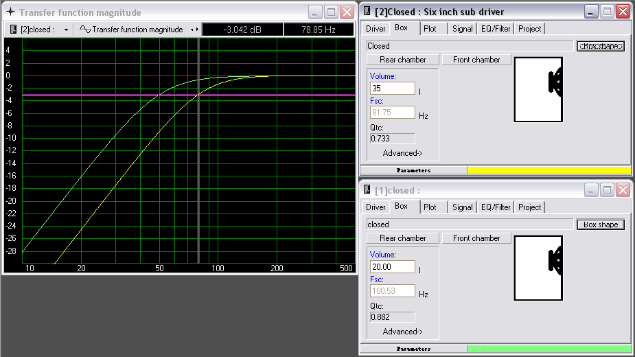

Hello,

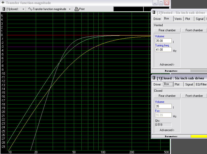

Here's a screenshot showing two simulations in WINISD. The yellow line represents 4 drivers in a sealed 35L box, with no EQ. The pea green line is the same 4 drivers in a 20L sealed box with a Linkwitz-transform circuit used to improve the response.

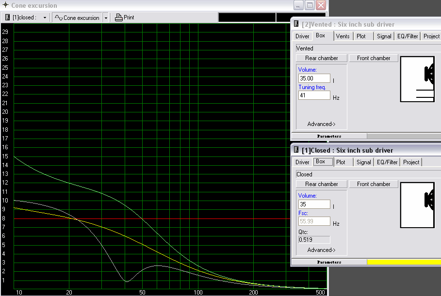

As you're having a sim frenzy at the moment, indulge me. What happens if you go with the four drivers as a pair of isobariks?
Hi PM,
As you might expect, the cabinet size is halved for the same frequency response, but efficiency drops.
2 pairs in sealed isobarik config in 35L is poor, completely overdamped and with little bass, and inefficient.
However, 4 pairs in 35L and ported is interesting - just look at the minimal cone excursion! These are all at 60w input.
This config would take over 500w before exceeding my imaginary 8mm p-p xmax! It could make some very loud bass, but presumably with magnets sticking out and also using 16 drivers (messy!)
Dunno, I think it might look quite cool. Two on the front, two on the back. It's got to be worth a test box, how else are you going to use up all those drivers! 🙂
