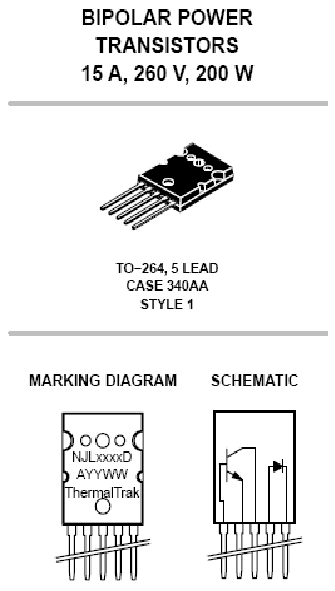

Has anybody tried the new ThermalTrak transistors from On Semiconductors? They have a diode for biasing built right into the package.
I was going to tell you to search, but then I did it and nobody had used them yet and reported back about it. I did find one interesting application note where the temperature monitoring was done with the inbuilt diodes in series on paralleled transistors, but that's about it.

Interesting devices!
Diode that senses the temperature, like a transistor in a VBE multiplier,
has its own 2 pins.
So the ThermalTrak is a 5 pins device.
See attached image.
Complementary ThermalTrak™ Transistors
NJL3281D(NPN) NJL1302D(PNP)
BIPOLAR POWER TRANSISTORS
TO-264, 0.625 °C/W
15 A, 260 V, 200 W
fT 30 MHz

I wonder how well they match off with standard MJL3281/1302? Since most amplifier designers will go with a VBE multiplier (and perhaps use several output transistors in parallel), maybe it will be viable to get just one NJL device, use its thermal diode for bias tracking, and use standard MJL stuff for the rest - cost savings, assuming these transistors are reasonably matched...

Actually it seems a good idea to put the diode into the package, (check Doug Self's site and book - he's done some studies on the issue of thermal tracking) - seems there's quite a bit of thermal lag using the more usual mounting methods. Self recommends mounting the sensor (assuming plastic pack output transistors) on the front (plastic) of the outputs, as this actually heats up faster and is a better representation of the die's temp.
I guess if one is really trying to keep his outputs optimally biased (exactly Class B, avoiding gm doubling) this would be worth a try...
