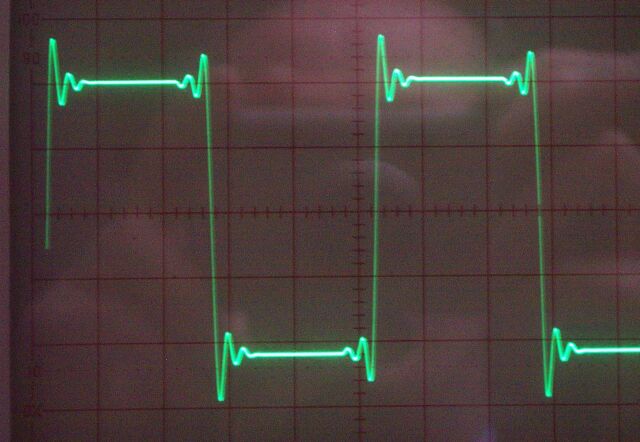

Here's where it starts to get interesting! This pic is of the
output of a very ordinary 11 year old Teac CD player when
playing my test CD I made, this track is of a 1kHz square wave
at -3dB. The ringing and overshoot is as expected.

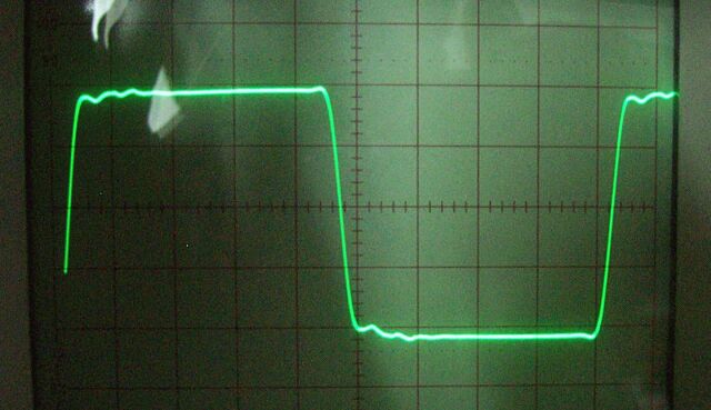

Now this pic is the speaker output of my pc sound card, a
Creative CT3600 SB32. To make super sure, I ripped the track
of the test CD and saved it as 44.1 kHz wave file. Then I
played it using Winamp http://www.winamp.com/ and the output
is like you see. Notice the very great reduction in ringing!
The sloping top and bottom of the waveform is because the bass
response is not flat because it is only adjustable in coarse
notches. What do we do now? Rip all our CD's to wav's and play
them with Winamp?
GP.

Some thoughts on the square waves you played. Your TEAC CD player I would expect oversamples, but maybe not very much. It is quite possible that the oversampling is done with a non-linear phase digital filter, butterworth, chebychev, etc. as opposed to a linear phase digital filter. The non-linear phase filters take less computing power and hence lower cost so they were used in early oversampling filters. It could also not be oversampling and have a brick wall analog filter that is almost definately not-linear phase.
Your Sound-Blaster has a more advanced digital-analog filter section. You would find similar results in modern CD players, even cheap ones.
Alvaius
Please let's not forget that a digitally-synthesised square wave is an illegal signal in a system that relies on proper anti-alias filtering at its input (i.e. during recording). In other words: there is no way that by means of recording an analogue real world signal with an ADC, you can end up with that particular test signal on the CD.
As such looking at square wave reproduction of CD is a bit pointless. All it does is reveal to you the nature of the digital filter, which when it is an approximation of the ideal Sinc filter, is supposed to have pre and post ringing. Sinc itself, the perfect reconstructor, rings ad infinitum.
