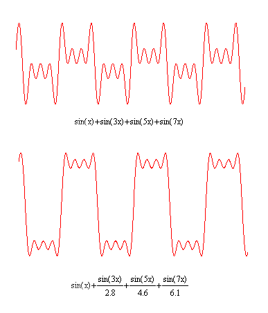

I was patient, I did try that function, but something was wrong... see the picture. It seems a lot of thing depends on the amplitudes of the harmonics.
According to my spectrum analyzer (and Blackman window) sin(3x) has amplitude which is equal to 35% amplitude of the fundamental freq, sin(5x) has 21% etc. So, I put amplitudes (only approximately) in that equation and I got sin(x)+sin(3x)/2.8+sin(5x)/4.6+sin(7x)/6.1
If you think now I will agree this should be, no, I will not. Because the harmonics exist till some frequency, and they have their full amplitude, and then all higher freqs harmonics completely disappear, here we have (“ideal”) brickwall filter.
In reality we don’t operate with such filters. Actually, filters attenuate slowly. Changing spectral content and internal amplitude relations between harmonics inside one squarewave, you also change the form you get. Attenuating slowly you’ll get slow transition from squarewave toward sinewave. And you will not get any ringing.
Pedja
Doh! Silly me. I forgot to include the amplitude factors... duh :headbash:
The equation should be:
y = E(n=0->infinite) [1/(2n+1)]sin[(2n+1)x]
where E is supposed to be the sum symbol...
broken down, it looks like:
y = sin(x) + (1/3)sin(3x) + (1/5)sin(5x) ...
Sorry about the confusion there...
If you want to see what happens when you attenuate the harmonics with a more realistic filter slope such as -80dB/dec. (4th order slope), you can simply multiply the amplitude coefficients by the proper attenuation value at each frequency... proceeding until the amplitudes are negligible. To do this, you'll have to pick a -3dB frequency, then do the log calculation to get the amount of attenuation.
Of course, this is assuming a completely linear phase filter, which isn't quite possible in the analogue domain (even Bessel isn't truly linear phase).
I think you'll still find ringing... 😉 That is, of course for something like a 1kHz square wave and a 10 or 20kHz -3dB filter cutoff. If you drop your -3dB point down close to or below the fundamental frequency of the square wave, then things change, and yes you can probably get something which has little or no ringing, but that's not exactly relevant to our discussion here though. As before, this ignores phase shift effects which will distort how the waveform looks...
