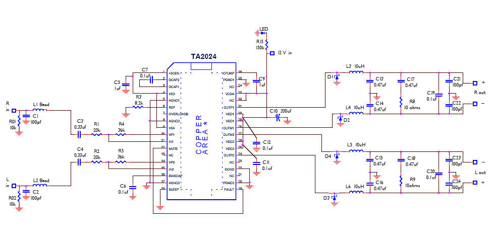

I want to change the following caps on my t-amp:
C3,C4 input coupling caps
c10 power supply?
caps on loudspeaker outputs.
These have already been replaced with the following capacitors.
cheap 4.3uF input coupling caps
cheap 2200uf power supply? (c10)
5% tolerence 0.1uF polyprop accross outputs
The changes I have made so far have made a fundamental improvement to the sound. Bass weight, dynamics, midrange clarity etc. much improved.
I have a second t-amp in need of tweeking... What would the best possible caps be? Please let me know if there's anything else easy I can do to improve things further. I want to keep it it it's cute case, as I will build a charlize at some point soon.
Cheers for all the help so far.

This is an important subject, changing the caps on the T-amp can make worlds of difference.
Use good quality film caps on the inputs. Blackgate also work well and are very small. 2.2uF is as large as you should go. If your speakers don't play down below about 40Hz, you can use 1uF.
So far, there has been no "definitive" input cap chosen.
Generally speaking, you don't want a cap in this position that is known to be "bright".
How did you get 2200uF in place of C10? Did you solder it to the bottom of the board? For C10, I like Panasonic FM series 680uF. They are hard to find in the UK, so try FC series.
There hasn't been much work done with the terminal output caps. More needs to be done here. These caps are to attenuate RF on the speaker lines. ~600K-3MHz
I'd love to see this thread expand. The caps in this amp can really change the sound, it would be nice to hear what others have found. So far the results are scattered around the forum.

I'm building 4 amp3's which I'll be using to test a couple different types of input caps. I've got 2.7uF Sonicaps, 2.7uF Auricaps on the way, and will probably also audition the supplied 3.3uF Panasonic FC electrolytics as well. I have many hours of listening with the supplied 2.2uF ceramic caps and they sound just fine to me.
The first amp3 kits from Jan used 25V 330uF Nichicon HE supply caps on board. The latest kits come with 25V 470uF Panasonic FM supply caps. Don't know how that will affect the sound, if at all, but the FMs should have slightly less ESR than the HEs. I'm sure Panasonic FCs would also work well here although they do cost a little more.
I haven't tinkered with the caps in the output filter because the on board surface mount caps do a good job of filtering and take up much less space than a quality propylene cap. The amp3 also uses 0.1uF differential output caps right next to the outputs on the PCB so there really isn't a need for one across the binding posts, although you don't have to install the ceramic caps on the PCB and could use a polypro across the outputs instead.
The thing about modding these little guys is that a pair of good quality caps can cost more than the kits themselves! Plus they sound damn good "stock" which it makes it even harder to justify the price...

The 2200uF cap is in one of the battery compartments ;-)
I actually connected it in parallel with the existing c10 because I was worried about moving the cap so far from the chip.

I believe the imput caps are there because the TA2020 chip inherently has a DC bias on the input. Therefore the input caps are NEEDED, not to block DC form going in, but to block it from "going out", so to speak.
edge540 said:is it possible to simply remove the inputs caps? Don't be affraid
NO it is NOT, alas.
This has been covered elsewhere. See this post.

On my ta2020 demo board I use 100uF oscon's for local psu decoupling and three paralleled 1500uF panasonic FA series a little further back.
I use 4.7uF Black Gate N types on the inputs (because I had them already and they fit nicely).

Well for what it's worth, I've put two 1000uF Nic NRSK's directly decoupling C11 & 12 and took the original off the board, just behind that are 4 x 2200 FM's in parallel before my stock Maplin PSU. Quiet as a mouse!
The input caps are Obliggado 2.2's with 36K's taking them in just before the pins (I also moved one of the feedback resistors closer).
The sound is excellent but I'm running in a set of FE207E's and trying to get the balance right. Dificult to say exactly but the MLTL's are giving me plenty of bass and the soundstage seems to be opening up every time I listen to them.

sharpi31 said:What would be the problem with increasing c10 above the 2200uF
I don't see any problem at all, but there are those here who would disagree. My approach is to get a mid-size very low ESR cap on the board, with a large stiffner cap offboard. I like the way it sounds, more dynamic, tighter bass, wider/deeper sound stage. But there are a few guys on the forum who say the opposite is true. It's easy to test to see what you like.
What about the effect of increasing c3 and c4 (input coupling caps)?
You can, but there would be several disadvantages:
* The larger the input cap, the larger the power-on thump. Above 2.2uF it can get really nasty.
* In general, you want to go thru as little cap as possible. We all know that coupling caps effect the sound, why use more cap than you need? 2uF is as big as you need, 1uF would work well above 40Hz.
* Cost and size. Easy to understand.
