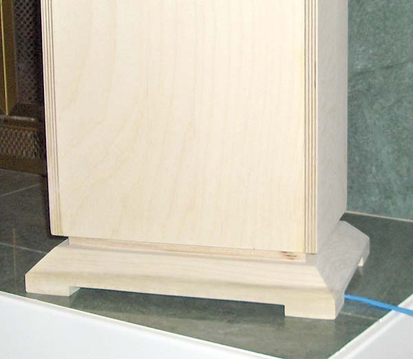

We have just fired up what on early listening seems to be the best FR/WR design we've done yet. We call them the Bipolar-Bipoles. About 25 litres sealed, FR125 on one side, WR125+ApexJr T (1.8 uF cap on the other). Intended to give us both trials of a sealed bipole, and to compare the FR125 to the WR125 + simple super tweeter. With the terminals in the base, it is completely reversable cosmetically. At about a metre high, and 6" wide they are quite compact, and according to the lady of the house "cute". Intention is to build future ones with solid wood front & back.
Initial impressions --The WR125 side has more extended top & better dispersion but the FR side perhaps a bit better image stage. Really, really close thou & much more listening required. One thing that is notable is that the little single ended tube amps aren't choking on this one (limited on volume & the bass isn't as tight as with the PP or SS, but nicer in the mids at low volume). I have posted this design in the box design library.
No finish on them yet...
attachment is the base wherein hides the terminals....
dave

sorry about the saw burn on the base filler, but I was in a hurry

Thats beautiful work.
