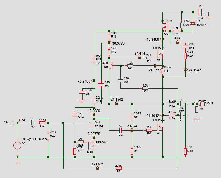

Zen v4jfet Cascoded
Blues said:
Jacco,
Next will be "Blues Buffer's Brother".
Found time to look for the lost brother. Anybody care to try this? Comments? Let me know if I missed something.
The jfet will dissipate about 100mW. Using the 2sj74 it will have about 4x safety margin with about 7V of stable Vds across.
Has anybody tried lower than 10Vds on a 2sj74 and still kept the coveted jfet sound? Now if only the guy selling 2sj74s will get back with me I'll have something to do this Christmas holiday.
Allan
hello Blues
I attach a small image of your zip.
Hope it is alright.
Makes it easy for lazy folks to view 😉
