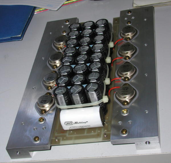

Motivated by yesterday's posts, I started work on Aleph X monoblocks. Most of the parts comes from my A75 which was taken apart fot that purpose.😉
It looks like it's going to be one of a few not commercial Alephs with TO-3 output devices. Since A75 used 12N channel mosfets per channel and I'm using 16 I had to use extras from my stash. Just out of curiosity, I checked the price and it appears that I paid $2.36 for one IRF230 in 1994. How much are they today?😉
The caps on board are 1,500u Panasonic HFQ. I checked the values and after 8 years of usage they are still OK. There will be more caps outside the board and resistor or thermistor between. Total capacitance per channel 128,000uF.
The power would be around 100W, PS +/- 20V DC, I'm using 4 banks of 4 devices per channel. I am not quite sure about the source resistors value, but I would like to use the same I used in A75 which is 0.56 ohm. Anybody please correct me if I'm wrong. The current would be around 6A for both sides.
The heat sinks are the same as A75.
Please note attention to details,😉 I'm not using screws to conduct the current, but rather Kimber wire soldered to mosfets cases.

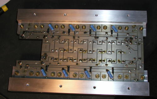

This is how the board looks from the other side. Had to resolder almost half of it (half the electrolytics had to change polarity). I liked to make the traces for output stage this way. I was drawing the spaces with a marker on mylar and it was it, no fancy software, no gerber files.😉 Picked that method from Yamaha, all their boards were design that way (minimum etching, maximum conductivity).

To solder to3 case, you have to "scratch" the surface where you want to solder the wire, and ou have to have a good soldering iron - because you have to heat up the case. Thats why a lot of ppl cant solder to to3, their soldering iron cools down, because it doesnt have good temperature distribution and not enough watts..
I hate using grease (especially when your amp has 48 output devices), and these ones were nice alternative to mica. They worked fine in A75 for last 8 years, so I didn't see a reason not to use them again.😉
Thermal impedance 1.13°C-in2/W (@50 psi)
Original sil-pad material

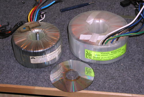

Here's how 750VA Plitron compares to 1000VA Victoria Magnetics (thanks Dale). I'm using primaries in series on my Plitron to achieve lower rails (20V DC in this case). The bigger trafo wouldn't fit my chassiss either; too bad cause it's quite impressive.😉

You call that a transformer? This is a transformer.
Surplus "1000VA" Bicron toroid custom designed for low flux density. Gift from famous audio designer friend since it was a cosmetic reject for a $5000 amp. Weighs 24 pounds.

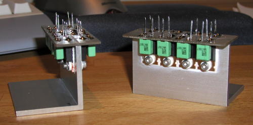

Just finished my discreet bridges. I'm using 2 bridges per channel, so 16 x 30ETH06 IRF diodes. I also did snubbers (however didn't have space for resistors so caps alone will have to do). The angle is both the mount as well as a heatsink. Clever layout reduced the number of connections and allowed compact size.
I only hope they are worth all the trouble comparing to regular bridges I was using untill now.😉
